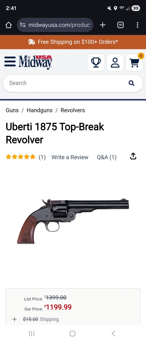

Crazy idea.
I understand from a mass production standpoint making this would not be worth it.
But... for a custom one off.
Don't see any Magnum Caliber top breaks. And I would like to have one.
How much work would it take or is it even be possible to make a top break in 454 Casull?
Can the frame be upgraded or would working from the ground up be the better option?
