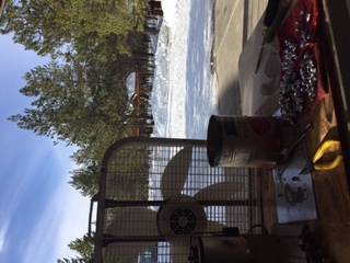

Casting
MTM
Sunday, January 29, 2017, 15:07 (3215 days ago) @ Gary Reeder
![[image]](images/uploaded/20170129220049588e661180452.jpg)
So I melted and cleaned about 10lbs of lead. Using both sets of molds, I made almost 200 bullets. I wanted to test the hardness, or if they were brittle, so I put them on an anvil vise, and gave them two hard hits with a 3lb sledge. The nose flattened nicely, no chipping or cracking, you could just about reload them. I think they look good. I'll play with sizing etc during the week, but it's easier than I expected so far.

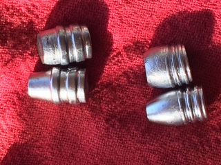

So I did not water quench. I poured the first few molds and let the bullets heat up the blocks before I kept any of the bullets. They cooled off quickly as I dropped them on some soft towels in 20 degree weather. I believe they will be fine for low velocity practice on the range. Is there a big difference in lubes? ![[image]](images/uploaded/20170130141244588f49dc5e25d.jpg)

Monday, January 30, 2017, 18:21 (3214 days ago) @ Gary Reeder
Your pictures are kind of hard to tell what is going on, but it really looks like the drive bands and base have rounded edges. The noses look to have pretty good fill out.
Try a alloy temperature around 700 degrees or just a bit more. Get a casting rhythm going that takes the sprue 3-4 seconds to solidify. Don't admire each cast as it falls from the mould, (time for that later) your mould is just cooling off especially in that cold weather. If your sprue hardens faster than that don't turn your pot up, cast faster, or slow down the cast if it is taking longer.
When opening the sprue plate, if it smears the lead it is still too hot, if it pulls a divot from the base it is still just a bit hot, let it cool a few more seconds. Although I've never noticed a small divot hurting anything.
The inspection you do want to do is, when you crack the sprue plate open make sure the base fill out is full and sharp. If anything else, don't waste a 4 1/2 cent gas check on it.
As time goes on you will find what works for you and your moulds. You may want to toss all this out completely.
