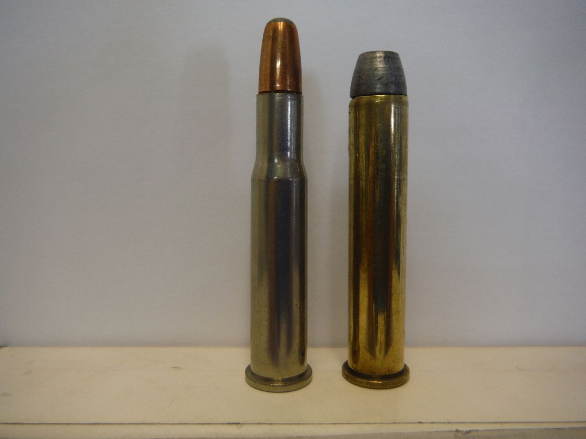

30-30 blown out to .400
Asa
Saturday, September 28, 2019, 10:29 (2601 days ago) @ MWC
Thanks ASA!!! Anyone got pictures of a comparison???
MWC
Saturday, September 28, 2019, 11:22 (2601 days ago) @ Asa
Next to a similar cartridge???
I like the idea in the 336!!!
30-30 on the left, 400 GNR on the right
Saturday, September 28, 2019, 11:44 (2601 days ago) @ MWC
Thanks, Mr.Reeder. Looks like a 'THUMPER"
