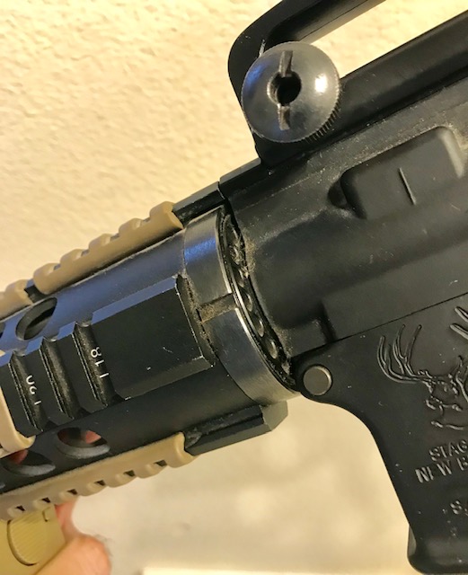

I think I have it figured out but I bought
Tuesday, October 15, 2019, 18:45 (2584 days ago)
it as an assembly. It looks like the big ring uses a spanner to unscrew that tube from the proper barrel nut. The spanner nut is thin and runs above the through gas tube. That has to be it.

Tuesday, October 15, 2019, 18:53 (2584 days ago) @ WB
Just back the locking ring off a little. It is like a jam nut locking the handguard down. Once you back it off, then you should be able to unscrew the handguard from the barrel nut. At least that was the setup on an AR I once had.

Tuesday, October 15, 2019, 19:57 (2584 days ago) @ Steve
It does not look like it has much threads. Plus without such a set up how would you align the rails?
