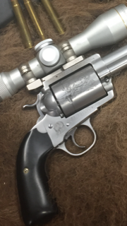

Leupold DD mount on a bisley
MTM
Sunday, October 20, 2019, 17:43 (2579 days ago) @ Josh
