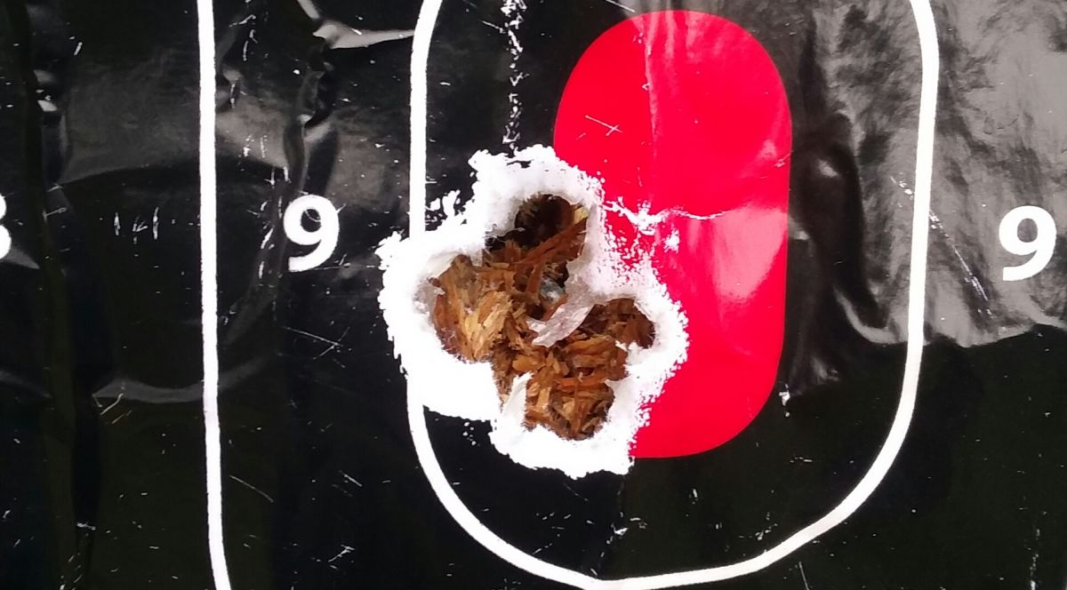

Using the fairly new Win 572 powder, the 44-40 really came to life.
REMEMBER THESE LOADS ARE FOR STRONG MODERN GUNS ONLY. NOT COLTS OR SIMILAR STRENGTH GUNS.
Worked up to 30,000 psi using published 44 Magnum data and similar case capacity.
Seating GT Hollow Point 245 grn cast bullets over 11.0 grn of Win 572 has been my accuracy champ. Producing 1300 fps and one hole groups at 25 yards.
![[image]](images/uploaded/201910262058425db4b38251a89.jpg)
