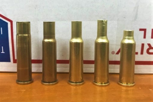

I collected a cool barrel set from a very generous friend and initially had some too hot loads I began with. I had to gingerly hammer the brass out of the chamber, I only made a few rounds. It was blistering speed though, lots faster than it's size would hint. Basically a .25 Herrett, the .25 American.
I'm getting it back out. Generosity again bestowed me some formed .357 Herrett brass. I narrowly escaped a purchase of an old .357 TC set-up. I didn't really need another project. So I figured I could justify reforming it to this cool .25 American.
I do have the rare .25 American dies. How to get there from .30-30, much less .357 Herrett, is another matter. I had to dive in my pile of in house dies. The .300 GNR form die is wonderful for many purposes. I use it first to neck down from .35 to .30 and set the shoulder back far enough. Then I used a sizer for the 7mm BR to help neck from .30 to .284. Finally I was able to FL size the .25 American and cut it off to be able to form and load, fire-form the brass. This time I'll back off even more. It should be fun to shoot too.

Around for the caliber. Yes, when you get close to the edge it’s abrupt! I’m trying much slower powder this time too. That should help tame it a little.

To fireform with my 80 gr. Cast FNGC. Capacity is about 30 gr. with fine powder, same as .30 Herrett.

I loaded up a couple dozen, just forming loads
Monday, October 28, 2019, 17:16 (2571 days ago) @ Sid R
I used 4227 that I have become very familiar with. The bullet is a 80 gr. FNGC that I like for my .255 Banshee and .25-35 Win. I did not the barrel chamber has a very short throat. These are not far off the lands if you can envision a pointy bullet using this ojive. But it has a long neck too.
We’ll find a safe fun load. I hope to slip is between the .240 Banshee and .256 Falcon. Actually it’s basically the .256 Falcon cut by 2/3. But a less radical shoulder and the long neck.
