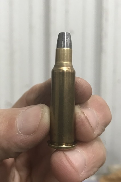

I used 4227 that I have become very familiar with. The bullet is a 80 gr. FNGC that I like for my .255 Banshee and .25-35 Win. I did not the barrel chamber has a very short throat. These are not far off the lands if you can envision a pointy bullet using this ojive. But it has a long neck too.
We’ll find a safe fun load. I hope to slip is between the .240 Banshee and .256 Falcon. Actually it’s basically the .256 Falcon cut by 2/3. But a less radical shoulder and the long neck.
![[image]](images/uploaded/201910290015495db784b532ea7.jpg)

I loaded up a couple dozen, just forming loads

- Looks like a little thumper. - Sid R, 2019-10-29, 04:08

Looks good but I bet it will build pressure quickly. (nm)
- Sean Harper, 2019-10-28, 10:13
If I remember right either Steve Herrett or Bob Milek
- Gary Reeder, 2019-10-28, 11:12
.25 Classic, not American. It is pretty big
- WB, 2019-10-28, 11:29
you are working with the same problem that the
- Gary Reeder, 2019-10-28, 12:55
- Yes, fat for capacity. Maybe a .25-20 load - WB, 2019-10-28, 13:48
