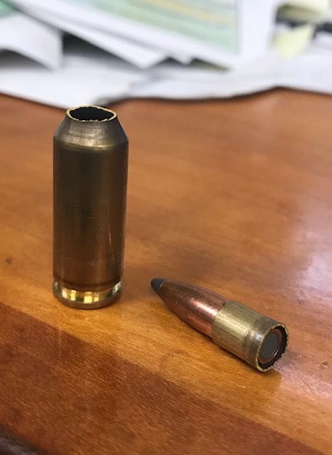

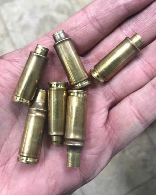

I put it away only to re-discover it at a later, more calm, date. These are $2 apiece Lapua .220 Russian Benchrest brass. Me thinks by-golly I'm gonna blow them back out! Hold my glass of sweet tea... although I do not think they'll ever be the same.
![[image]](images/uploaded/201910292132105db8afda1cf2f.jpg)
I have some loaded up and decided once to "unload" them with an inertia puller. I found the definition of "neck tension" It far, far, beats any crimp you can conjure. I figure not many loaders encounter the same "challenges" that I seem to find.

I was trying to make 6mm PPC from .220 Russian. Not a difficult task at all. Open up a .22 to .243. Well, you see some of the unique challenges. This benchrest brass is sort of raw, special stuff, made to neck turn to the closest 1/2 thousandth etc. I noted the top half of the cases were a nice blue hue.
I did load many cases but had about 15% failures on some level. I was pulling my hair out. Those telescopes were simple attempts to neck up with an elliptical expander ball. I still do not know why other than too soft shoulders. I've necked up a .22 to .416 just this week! But sometimes the bear gets you!

Mike Casselton
Wednesday, October 30, 2019, 11:38 (2569 days ago) @ WB
Scotty,
Prime them,
Get some powder somewhere between AA-1680 and H-335.
Fill it up to the neck and top off with a hunk of cotton ball.
Fire them and voila, you got a 6 PPC.
You can also fire them as 220 russian with cheap bullets and they will form about 98%.
Once fireformed, they are easy to work with.
