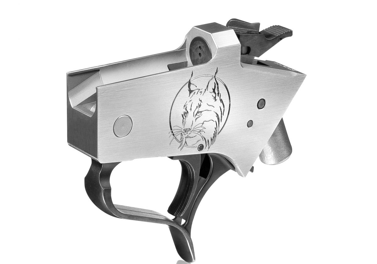

Regardless of individual thoughts, it's here. I'll probably always prefer the G2 simply because it's stronger. But, I can see this frame with several Black Chromex Barrels on it. Gary's been building me some retro calibers and this has a place with them.
I shot 250 Savage, 300 Savage, 444 Marlin and such barrels on G1 Frames for 25+ years with no issues.
All loads being equal, opening the action on the old style

Contender after letting down the hammer makes my nod go to the G2 especially during a hunt.

I like this new remake, not enough to rush out and buy it myself, but if Santa wanted an idea for a stocking stuffer, Groovy. Actually I personally need a new stls. G2. I own two Encores, a 1974 Contender "hard open", and Roman has absconded with my blue G2. The latter is a good one that fits about ever barrel I have. I did have to swap the bolts on an old 8-3/8 octagon .357 and a later barrel. Somehow the combination worked on both barrels when swapped.
One trait I really disliked on the Contender is if you are on the stand and "bump" the trigger it goes "click"! You have to reset the action by opening it again. Makes noise. If you bumped it at a bad time or didn't notice you had previously tripped it, only to find your hammer won't stay at full cock as the trophy buck twitches nervously 25 yds. away. One simply works around things like that if it's what you have to work with. BUT the G2 has no such characteristic. I do applaud that style hammer that has the dual pin and safety on it. Really nice to be able to have it cocked but on safe. I like that.

Internals as the originals? Seems like it could be designed to be re-cockable.

The new frame parts will be same as old model parts. Hence, replacement parts will be available for old frames. Heard Easy open conversions may be possibly started up again.
