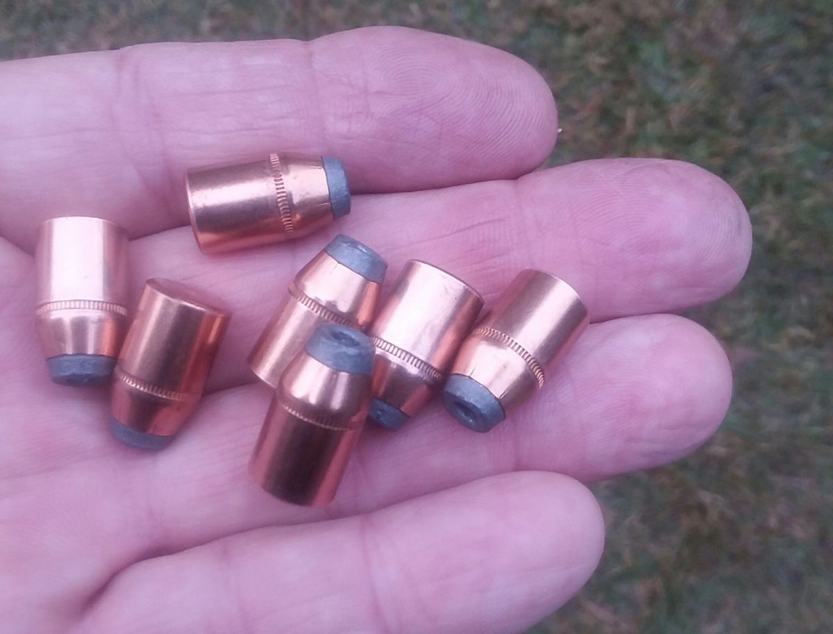

Checked the diameters of Sierra and Hornady 41 Magnum 210 grn Bullets.
They were both undersized too. The Sierra Bullet was .4085" and the Hornady was .409".
I lubed the bullets and pushed them thru my Lee .401" Sizer Die. Surprisingly, I didn't experience any "Spring Back" with the jacketed bullets.
They came out .4005", the same as cast bullets sized in the die. This will give a nearly perfect bullet for the 38-40s.
![[image]](images/uploaded/201911201318455dd53d352be59.jpg)
38-40 Bullet Problems Solved..

Great! You can do that with some.
- Jim Taylor, 2019-11-20, 06:34
I've found that if I size down too much..
- Huey, 2019-11-20, 06:54
Yes. I had that springback when trying to make .348 bullets
- Jim Taylor, 2019-11-20, 07:19
- It depends on the bullet construction, lube helps. - WB, 2019-11-20, 07:29
I'm guessing these didn't due to the jacket being...
- Huey, 2019-11-20, 07:28
