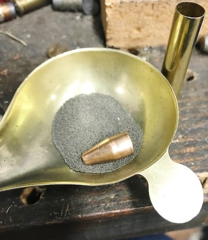

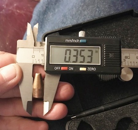

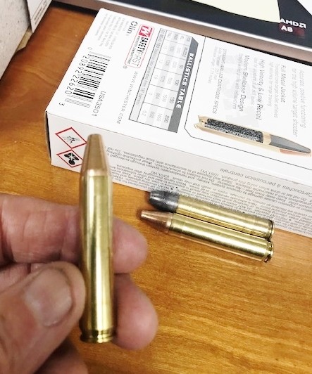

My LGS had some 145 gr. ball shooter ammo for $11 a box, a nice surprise. Plus I got to hear about his Montana Elk hunt, he and his son, horses, two Elk, great stuff. Hunting ammo was $28, with the fancy projectiles. I have not read much about the specifics so I had to find out myself. The case had 18.5 gr. of some fine ball powder. It makes me think it’s a little on the fast burn rate side with a 145 gr. bullet. My inclination is to stoke it with 1680 or 4227, a heavier cast bullet, and have at it. The bullet was a bit of a shocker, it is actually .353”, what up?! I have a .352” sizer, and a .356”. This is a bit of a puzzle. We’ll see.

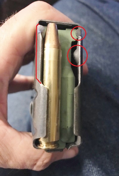

I need to buy a dedicated mag, they are cheap. The 20 rnd military mag seems to be able to hold and feed 2-3 so it will do for a test. The problem areas seem to be the highlighted parts. I read P-Mags mod easy too. Being a rifle pressure round and a lot of bullet surface area performance should be considerable. The factory ball is rated at 2250 fps, seems low. If anyone knows of a more technical article on the .350 I’d sure like to read it.

bullets are supposed to be .355". I think the factory
- Sean Harper, 2019-11-22, 07:03
I checked with 3 different calipers, the 145 is 0.353".
- WB, 2019-11-22, 07:56
