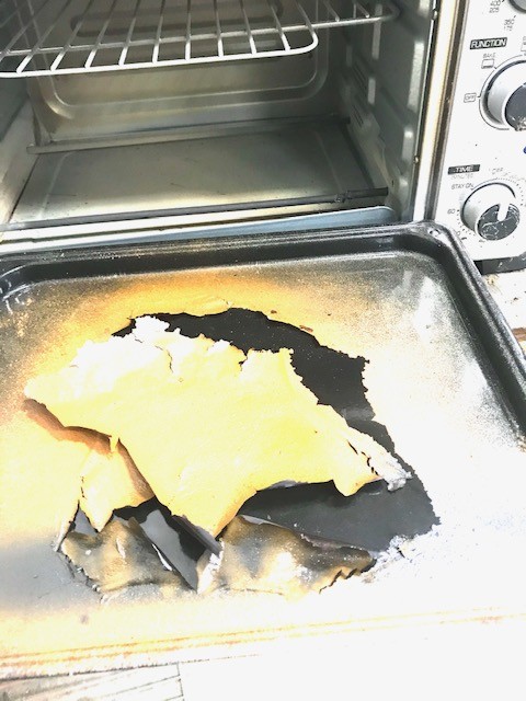

Painting encapsulates the lead and allows it to shoot in semi-autos better without gunking things up. Of course I have to go buy a new toaster oven. Still don't know why it blew up. The element under the pan burned through, must have touched the metal pan and created a dead short. It made a white arch fireball in the center of the pan and blew off the non-stick coating on the pan. Anyway it's done. Of course it blew the 20A breaker, but it took long enough!
