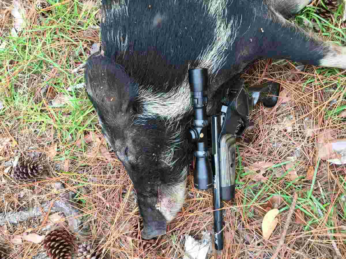

Here is a hog I took with the 330 Falcon last January with the Barnes 160gr X Bullet at 2250 fps, shot was about 50 yards quartering,the blood is the exit hole, she went about 40 yards and piled up.
Sean

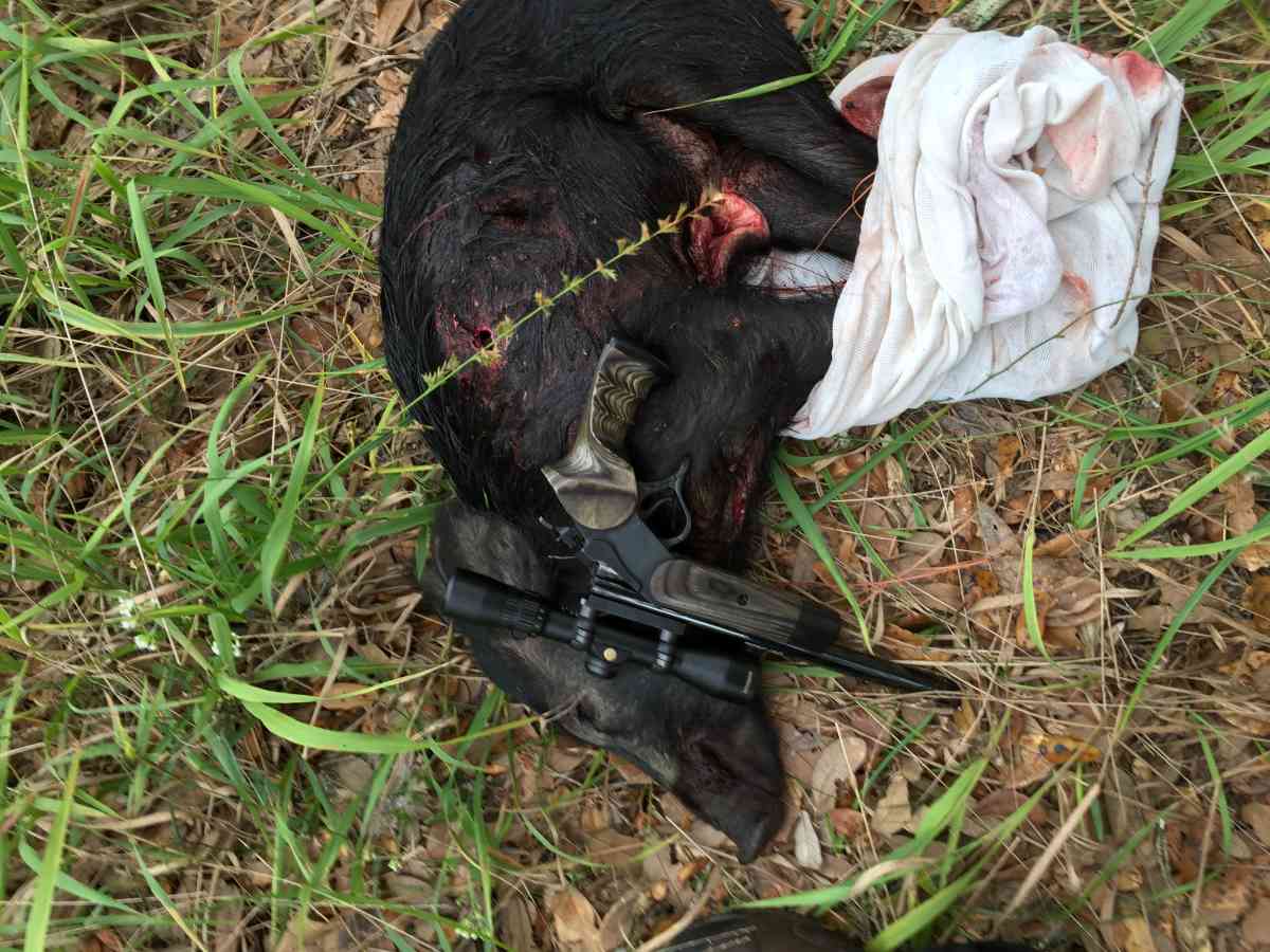

They expand fine!![[image]](images/uploaded/201912031604335de687917f85b.jpg)

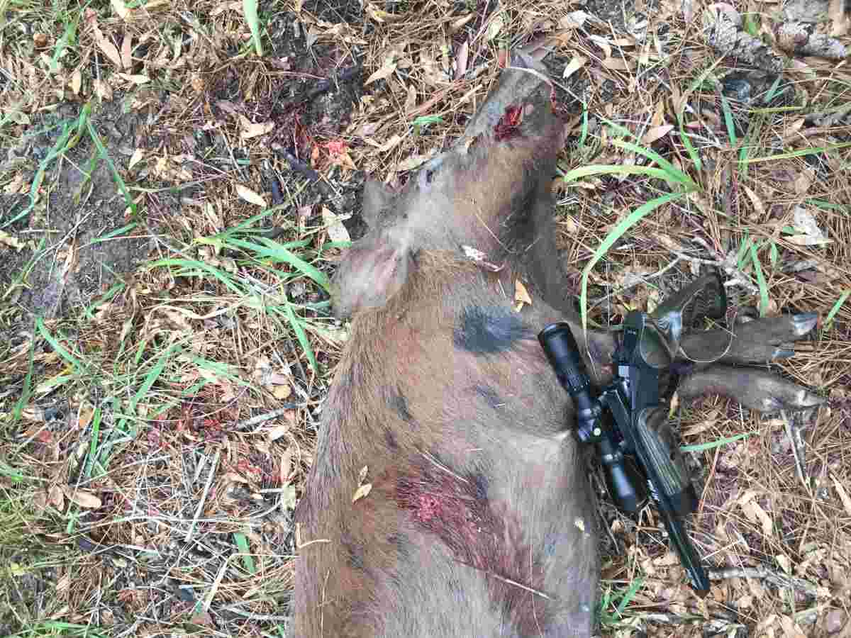

![[image]](images/uploaded/201912031605465de687da6d535.jpg)

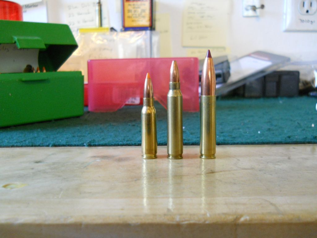

I have lots of these and they work great bellow 338 Fed or 338 Express velocities, 200 gr FTX, Nosler BTs and Barnes 160 TTX, I have a custom cartridge of my own a 223 based 338 it is a might slow but 1 hole at 100 yards is where I'm at, The Falcon just sounds I need one cool
Have a pic of that 223 necked up to 338? Like to see that
Vern
Tuesday, December 03, 2019, 11:28 (2535 days ago) @ Sunny
Yes please
Josh
Tuesday, December 03, 2019, 12:25 (2535 days ago) @ Vern
pic 223 338
Sunny
Tuesday, December 03, 2019, 14:13 (2535 days ago) @ Vern
left to right 221FB 223 Sunny's33![[image]](images/uploaded/201912032113165de6cfece2c97.jpg)
Cool, totally unrelated, a guy was doing that but shorter
Tuesday, December 03, 2019, 15:10 (2535 days ago) @ Sunny
and rebarreling .351 Winchester rifles to .338. The .223/338 rounds had to be short enough to fit the magazines. The round was in one of the 10-12th editions of Cartridges of the World.
That is another contender for a straight walled potential hunting ctg. Goofy ass law but what innovation it has spurred.
Sunnys33
Sunny
Tuesday, December 03, 2019, 17:18 (2535 days ago) @ WB
the nice thing about this one is no special dies just use a 223 for the body a 338 M die or just an expander from a 338 Fed or a Lee universal expander(flaring)will work also I have a Hornady 338 seater and share it with other 338s I have, Now I may have to find a 338 Whisper

Yep you can see the size of the exit hole on the middle pig
Blake
Tuesday, December 03, 2019, 10:34 (2535 days ago) @ WB
The third big shows a entrance hole. The performance was the same on all 6 hogs I have shot this year
