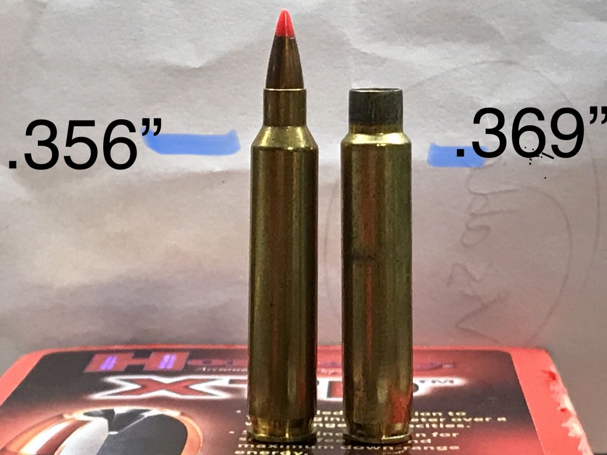

Joe W
Friday, December 06, 2019, 05:20 (2532 days ago) @ Josh
![[image]](images/uploaded/201912061218475dea47273cfc8.jpg)
Not as fancy as waterboy but I gave it a go.
Can you fireform using loaded 204’s?

Answer; maybe. New ammo may fireform from .204 to .257 Raptor just fine. The TC holds the case by the rim-notch and will fire it for sure. But that is a pretty big jump from .204 to .257 and might split. Sometimes we even anneal brass necks to expand in a step or three up to that .257 just to be sure. Like .22/.243/257 It's better safe than sorry. It's part of the fun too. You can't get a 100% definitive answer but you have to make your own choices given the information.

making any of the Raptor round without annealing
Friday, December 06, 2019, 15:57 (2532 days ago) @ WB
the neck is almost impossible. You need to anneal, and then go up in 2 or 3 steps.
![[image]](images/uploaded/201912061208555dea44d798241.jpg)
