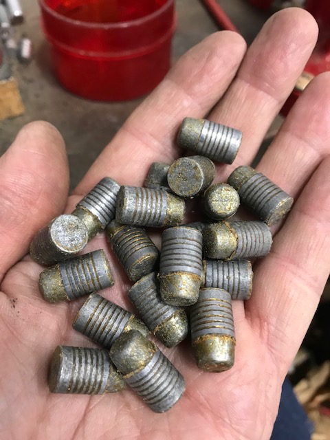

You know they were big on that "tumble lube", liquid alox lube. But those bullets designed special for it you really don't have to size at all. They drop out of the mould about 0.002 bigger than you'd call for but the multiple small grooves have huge surface area to hold the .22 RF style lube. They also "crush" to fill rifling. The only critique is they are a bit messy to treat and smoky to shoot. I usually get too much on them, they say a little is enough.
These have been custom "sized" down from about 0.412 to 0.401.
