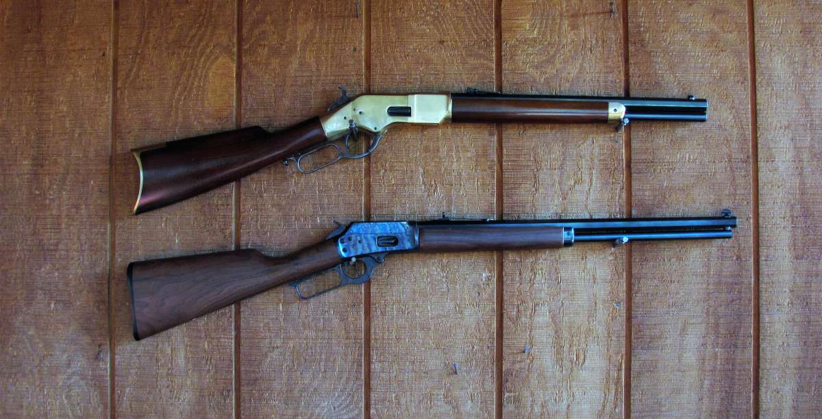

Also I found mine had a bit weak extractor, it would sometimes jump it and I'd have to pry it out with my pocket knife. The .45 Colt was never a factory offered round in the carbines. I think this the reason, that teeny rim, compared to the .44 & .38 WCF, .32/.25 -20's.
I love the slick function of the 73 and 76' actions. I also like how the ammo is exposed and you can see the mechanics in function. I need to get me another. I like the 24" (such perfected heft and carry balance) version but the shorter ones have my eye too.
24" TOO LONG FOR ME; I CUT
Sunday, January 12, 2020, 17:42 (2495 days ago) @ WB
'EM BACK TO 16"
Don’t know much about the 1866, have seen
Sunday, January 12, 2020, 20:32 (2495 days ago) @ JT
Some good deals on some used ones in .38 Special. No side plates?!

the 1866 was the one they called the Yellow Boy, and had
gary reeder
Monday, January 13, 2020, 19:05 (2494 days ago) @ WB
a forend as opposed to the 1860 Winchester (Henry) with no forend.
