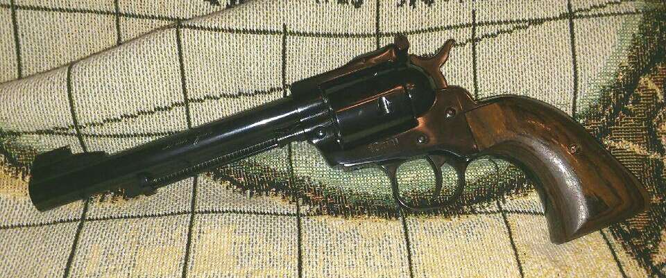

This is still my favorite. I handload 180 grn GT Hollow Points at 1300 fps with very low pressure. The 6.5" barrel and none existing barrel gap really boost velocity over my 5" autos. There are zero downsides to a 10mm Trail Gun...
A Reeder gun? and 6 shot?

Reeder Trail Gun 5-Shot...

Monday, January 27, 2020, 16:49 (2480 days ago) @ Claire J.
is that in a Blackhawk?

Monday, January 27, 2020, 16:50 (2480 days ago) @ Huey
Single Six...

I have them in both 10mm and 40 S&W...

That's because they were the first built for sale. It took a bit of talking to get Gary to do them.
At this point selling one and adding an auxiliary cylinder in the opposite caliber seems logical. But, both of the builds are as flawless as Swiss Watches. I just can't part with a gun as precisely built as these.

I bought a single seven in .327 when they first came out and I really like it, I just think in that same frame a 10mm/.40 would be really cool. I think an SP-101 in 10mm would be cool but don't know if it could be done or not without costing a fortune. I'm sure it would be a ton of work to make it work. And no I wouldn't get rid of yours either, bet there awesome!
