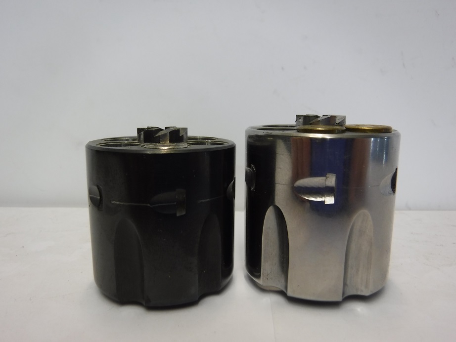

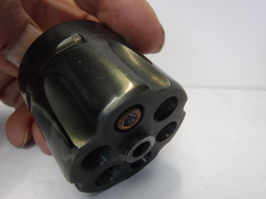

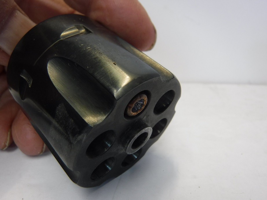

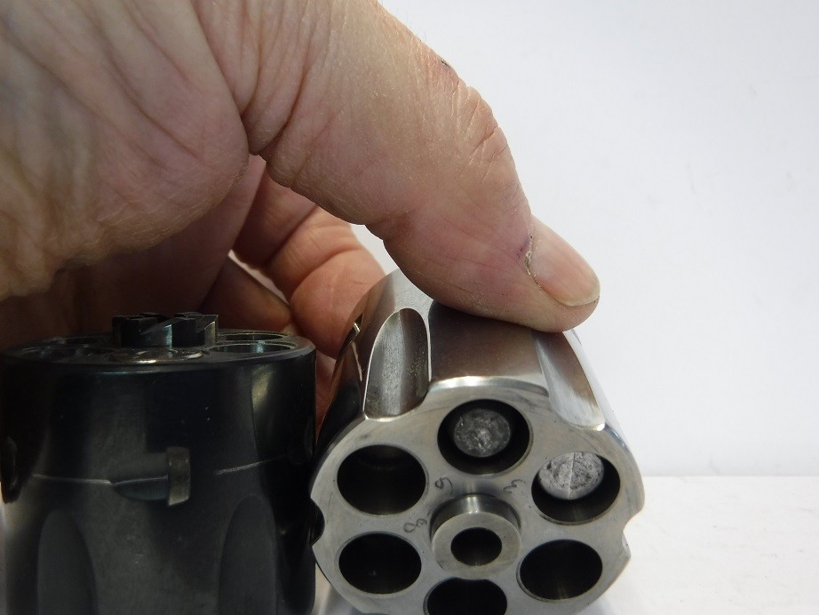

In the pics the stainless cylinder is the Super Blackhawk size while the blued cylinder is the mid frame size.
In the pics with the bullet noses showing a standard lightweight bullet in 45 Long Colt the bullet is fairly close to the end of the stainless cylinder while a 250 grain bullet comes almost to the end of the cylinder.
In the mid frame a standard fairly long nose 158 grain bullet in 357 mag comes all the way to the end, so some bullets wouldn't work at all.
