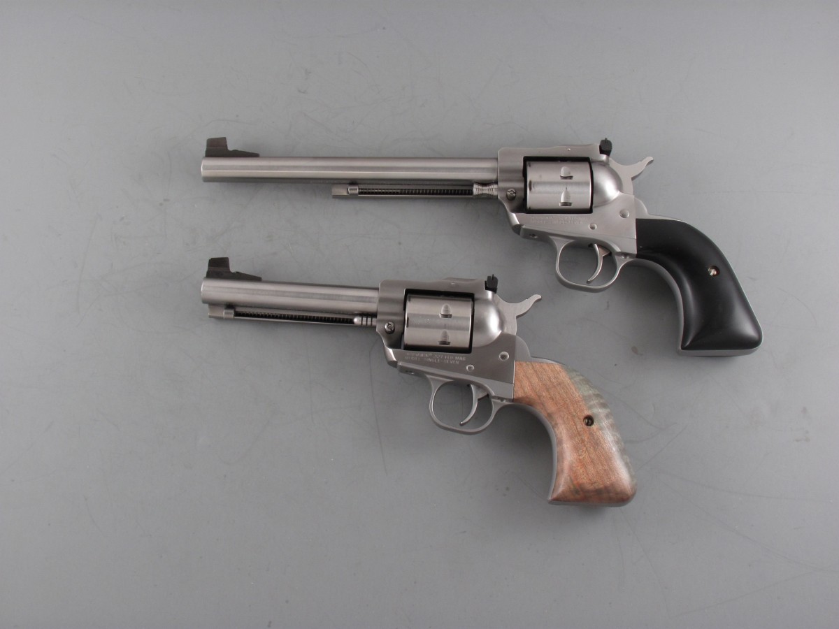

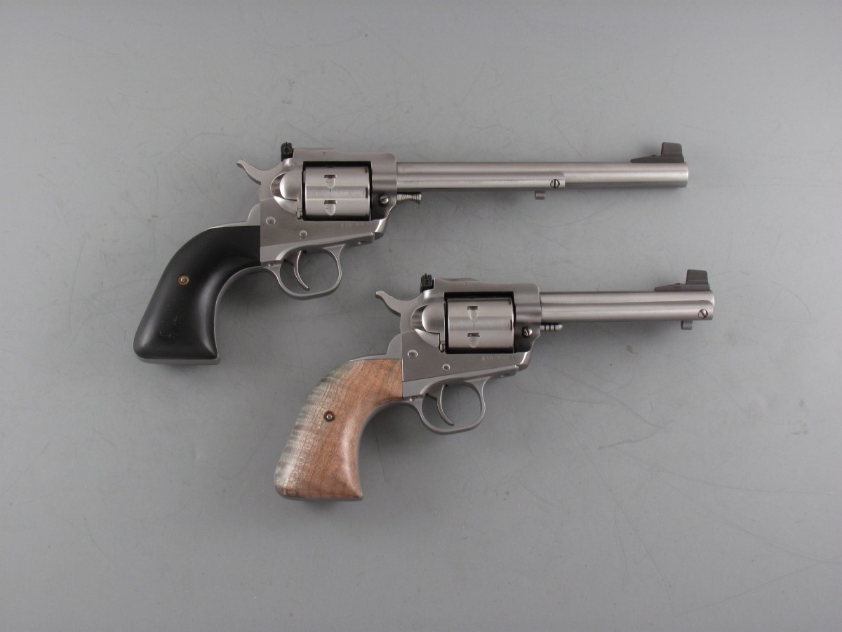

I bought this polished gripframe from Gary a couple years back. It cut 7.5 oz off the weight of this fine little Ruger. The gun came with a .0025" barrel gap. I slicked up the action and put in Wolff Springs. Polished the small parts and added a #5 Keith Style Base Pin.

respecting to caliber. That .45 Colt weighs in at 36 oz. but a .357 is a whole bunch heaver by percentage (15-20%?). It changes the balance and overall feel too. Those big empty holes bored in the steel.
I find a .357 with a short barrel feels a bit chunky, sort of clubby. The other calibers proportionately different in each direction. A .32 gets pretty hefty. I have a .25 cal. all steel Bisley with long barrel that is almost 3.5 lbs! I commissioned it, an 8-shot to boot, upon arrival and my first grasp I thought wow! I had not considered that at all. It is a real handful. Holds as steady as a rock and is a real joy to shoot but I did not consider a weight difference of some 10 oz. between it and a .45. Basically it is a solid chunk of steel with little bitty holes drilled in it, removing very little weight.
Not complaining, but it makes it interesting and I really notice things like that. It's hardly ever mentioned though.

You have the talent and experience to do gun smithing on single action guns. And a good job at that. Pete
Aluminum grip frame looks so good in a SS receiver.

Aluminum grip frame sweet

7 oz less that’s a lot does it make it feel nose heavy
Not at all...As WB pointed out, it's a 45 Caliber..
Huey
Sunday, March 15, 2020, 03:58 (2432 days ago) @ Tim Dollar
So, the gun is fairly light to start with. It compares favorably with my FA97 45 Colt for easy packing.
Accepts slightly longer rounds, 20% more fire power and cost a whole lot less.
