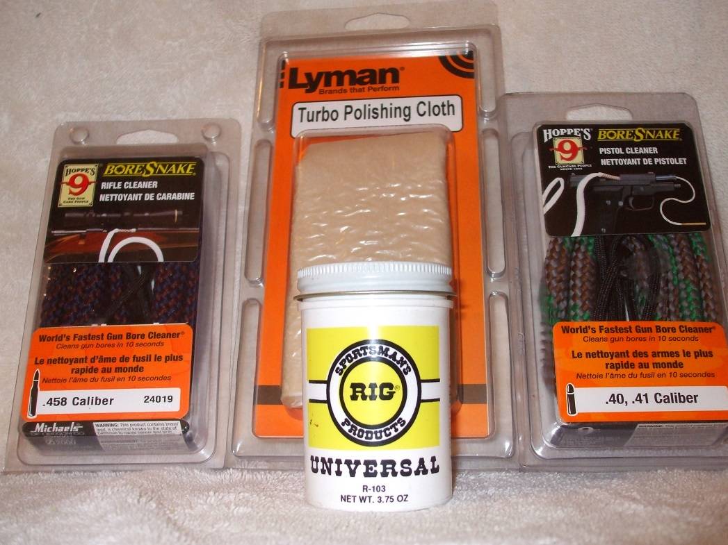

What is your preferred gun grease?
Bucky
Saturday, April 04, 2020, 22:10 (2411 days ago) @ Gary Reeder
I use Rig Universal Grease, and Bore snakes, that's it.
gary reeder
Sunday, April 05, 2020, 19:31 (2410 days ago) @ Bucky
The Lyman Turbo cloth has been dropped. At least i haven't been able to find any.
