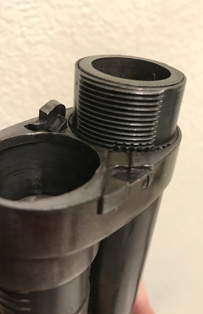

In the picture you can see the tiny notches. You loosen the little screw, slide that locking piece of metal clear and turn the collar counter clockwise to loosen fit or clockwise to tighten. The sliding piece of metal must engage two notches minimum to fully seat. The action/barrel will not rotate to close if that metal keeper is not fully seated. You finish by re-tightening that little screw.

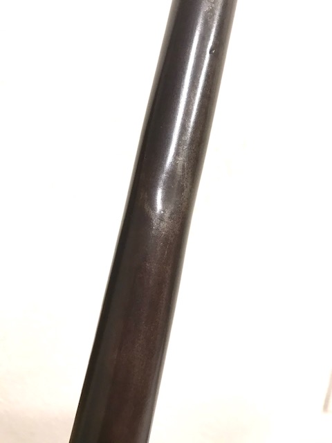

I just noted a dent in my barrel! Shoot. I guess it won’t hire anything except maybe a few pellets as they pass. Brownells has rigs to fix that but it would be easier to find a guy that has the tool already. The old gun was made in 1908, 112 yrs. ago!
