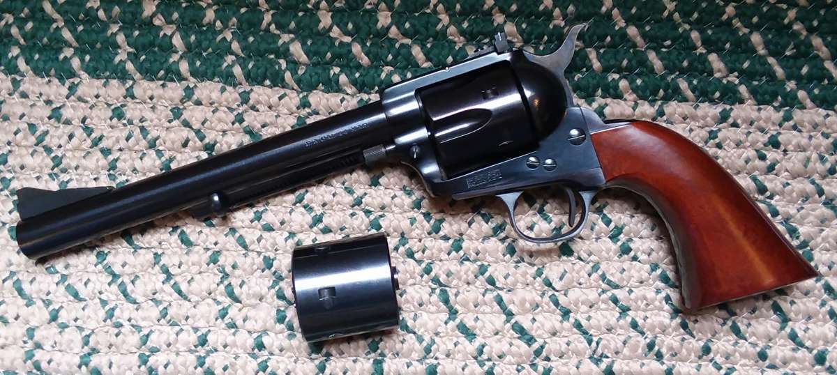

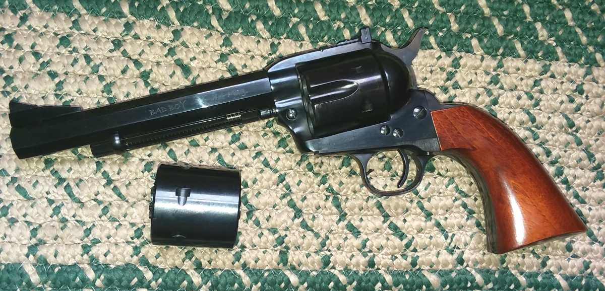

As we discussed a couple weeks ago, modern 44-40 use the same bullet diameter as the 44 Magnum. Gary chimed in and correctly pointed out that 44-40 Cylinders could be added to 44 Magnum and 44 Special Revolvers.
I had bought the Uberti Callahan 44 Magnum some years ago. I believe it was the Fall of 2012. More recently, I added the Cimarron Bad Boy (Uberti) 44 Magnum. I decided both should become dual cylinder guns.
This week I took the time to sit and hand fit 44-40 auxiliary cylinders to both. Uberti 44-40 Cylinders come with .431" throats and this works great with the .429" barrels.
Since these same models are available in 45 ACP, I've settled on 21k psi as maximum. This pushes the 220 grn GT Hollow Point at 12-1300 fps.
The 7.5" Uberti Callahan...
The 6" Oct. Cimarron Bad Boy...
when you have that cyl on-board Huey
MountainWanderer
Saturday, April 11, 2020, 14:56 (2404 days ago) @ Huey
would you please post a pic of that "Bad Boy"? Thank you!
I'm not 100% sure what you mean?
Huey
Saturday, April 11, 2020, 16:12 (2404 days ago) @ MountainWanderer
I surmise he means a pic with the other cylinder in?
Asa
Saturday, April 11, 2020, 17:10 (2404 days ago) @ Huey
"It puts the lotion on, or, it gets the hose again"
Yes: pic with other cylinder (Thanks Asa.)
MountainWanderer
Sunday, April 12, 2020, 16:20 (2403 days ago) @ Huey
Curious what it will look like with the flats of the gun and the octagon barrel flats...
