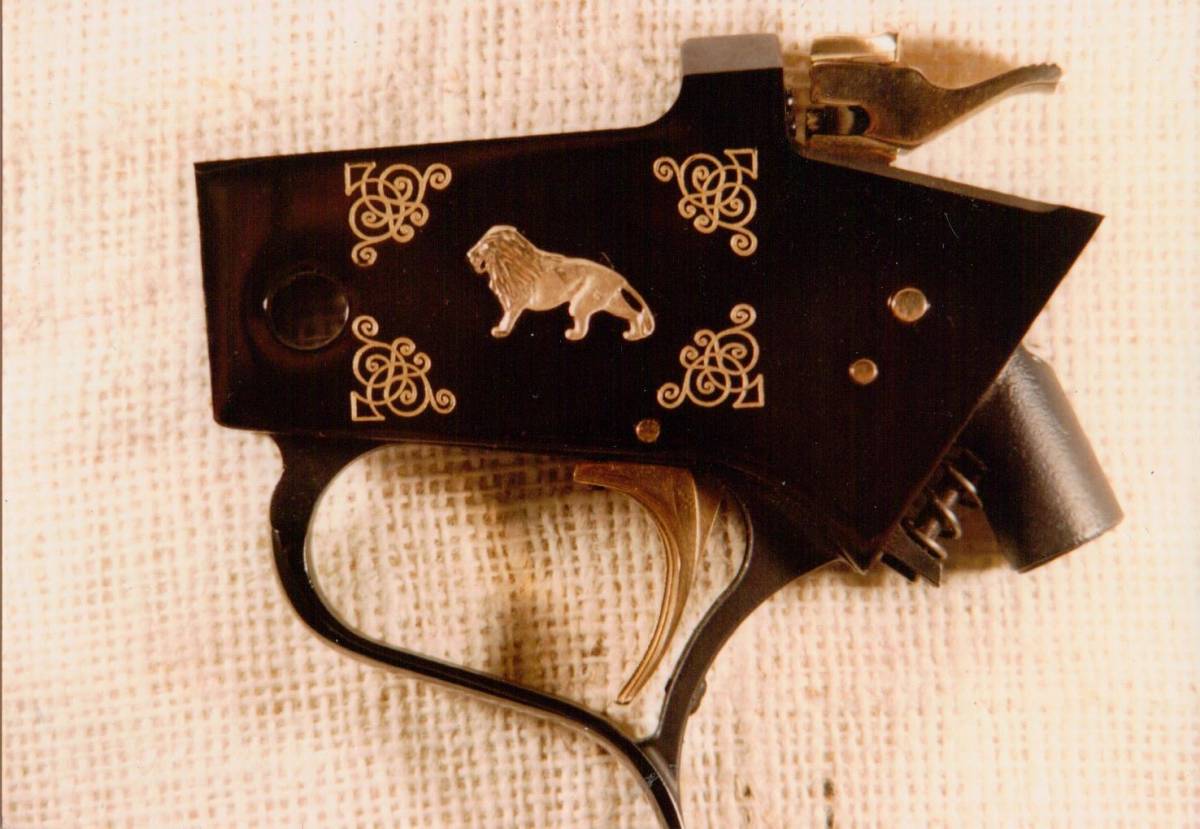

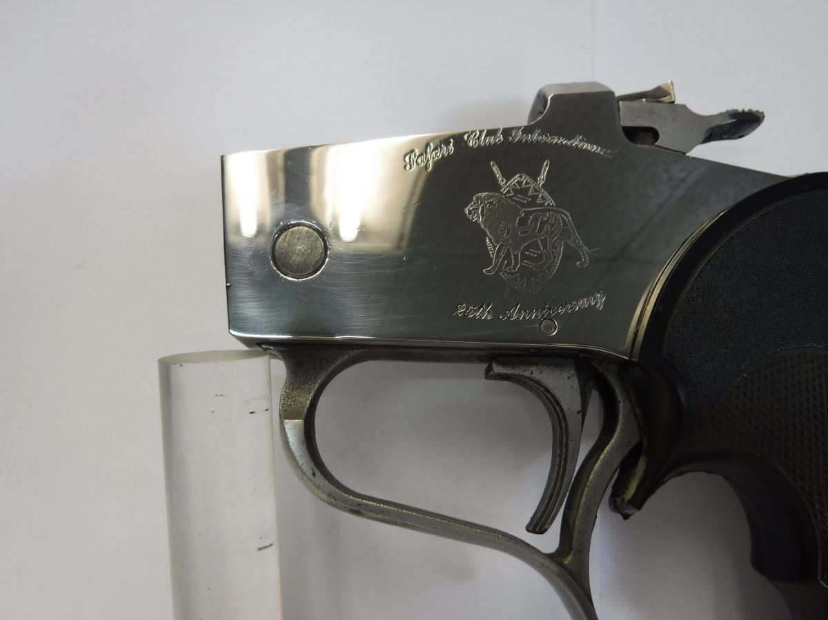

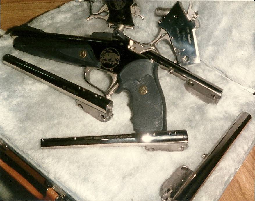

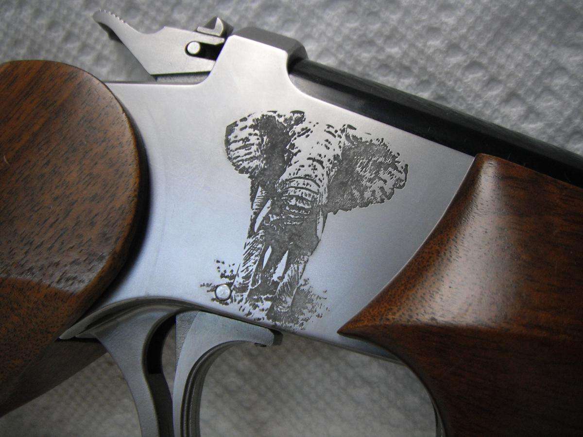

We had several in various gun magazines and several articles on them thru the years. We built 25 guns for Safari Club's 25th year anniversary and they had a speccial give away of serial number 1. I kept #2 and this is it. The frame was about 20 years old when I dug it out of the safe and took a picture of it.I had had it in Africa with me a time or two and it wasn't in the best of shapes by then.
![[image]](images/uploaded/202004212007545e9f529a3fbc2.jpg)
![[image]](images/uploaded/202004212010165e9f5328c25f1.jpg)

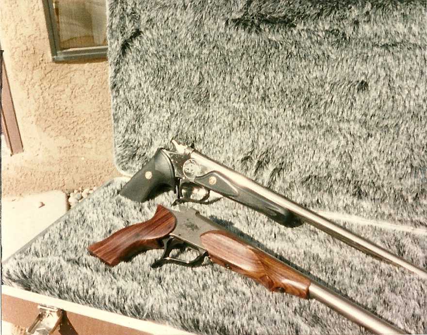

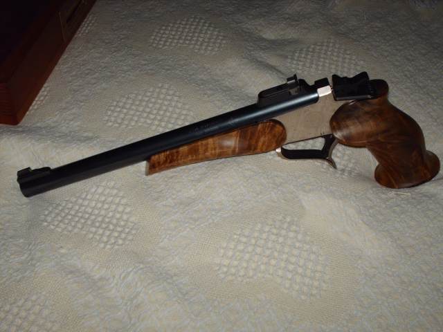

In '78 and '79 we built some long range Contenders with longer than normal barrels.
![[image]](images/uploaded/202004212011595e9f538faa078.jpg)

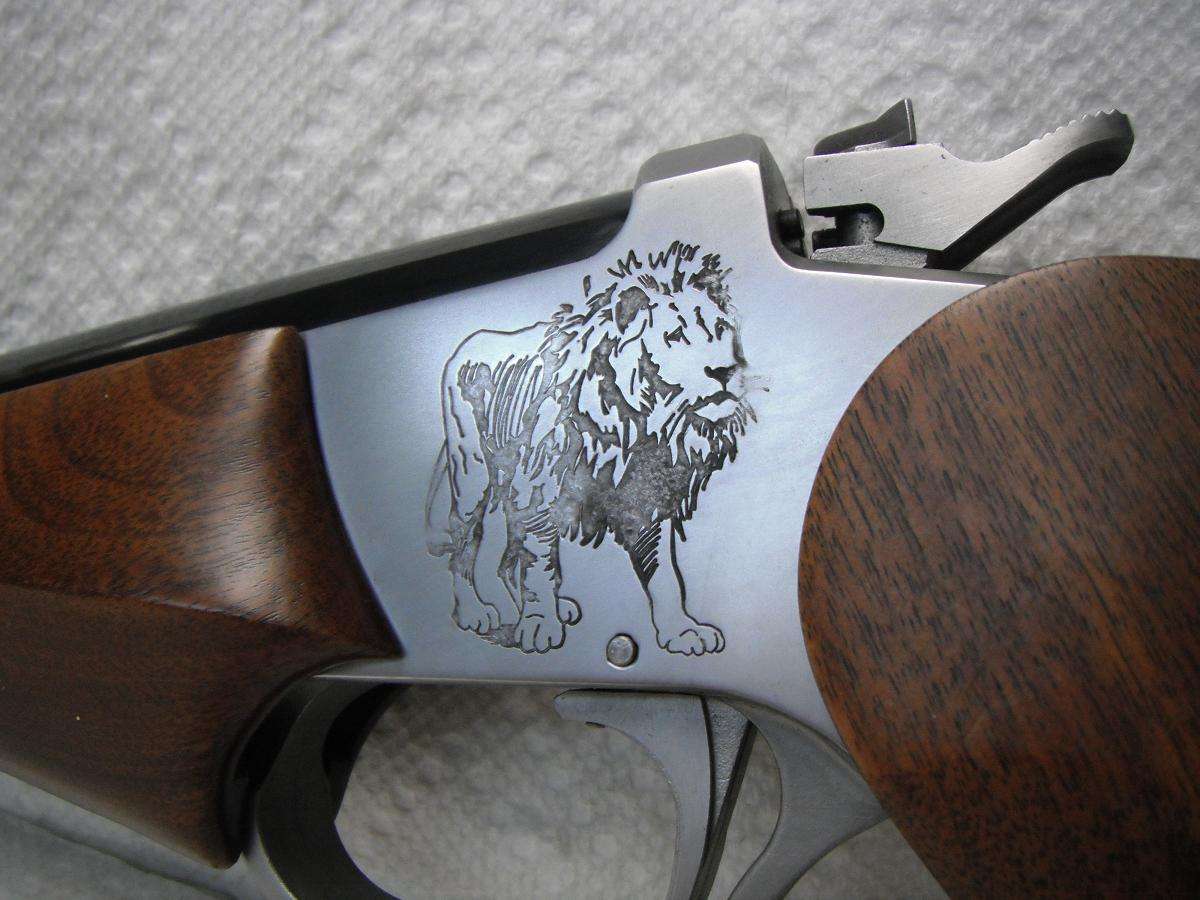

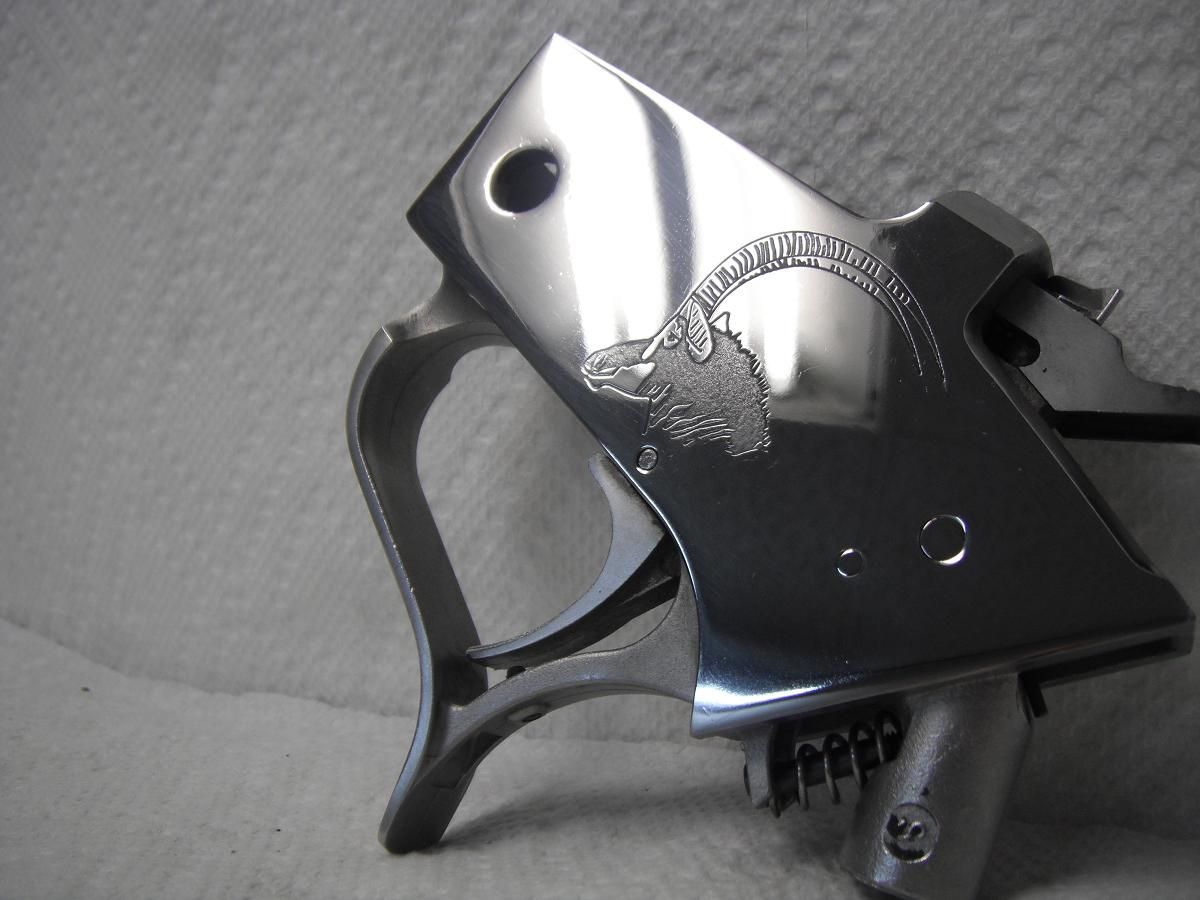

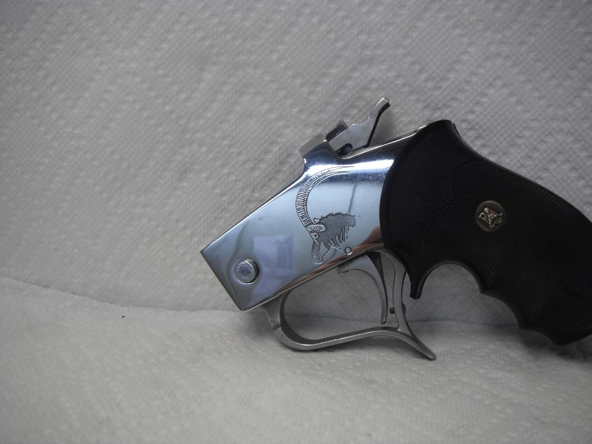

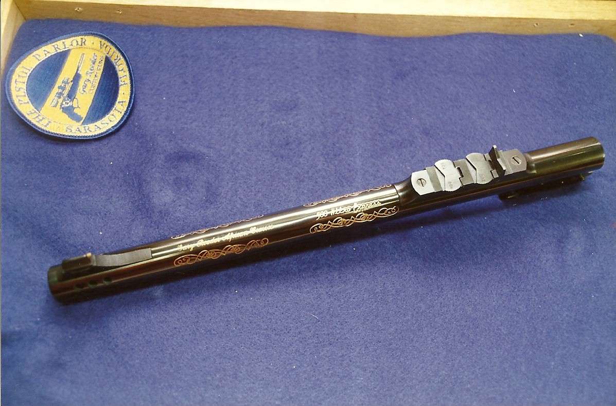

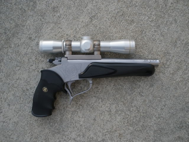

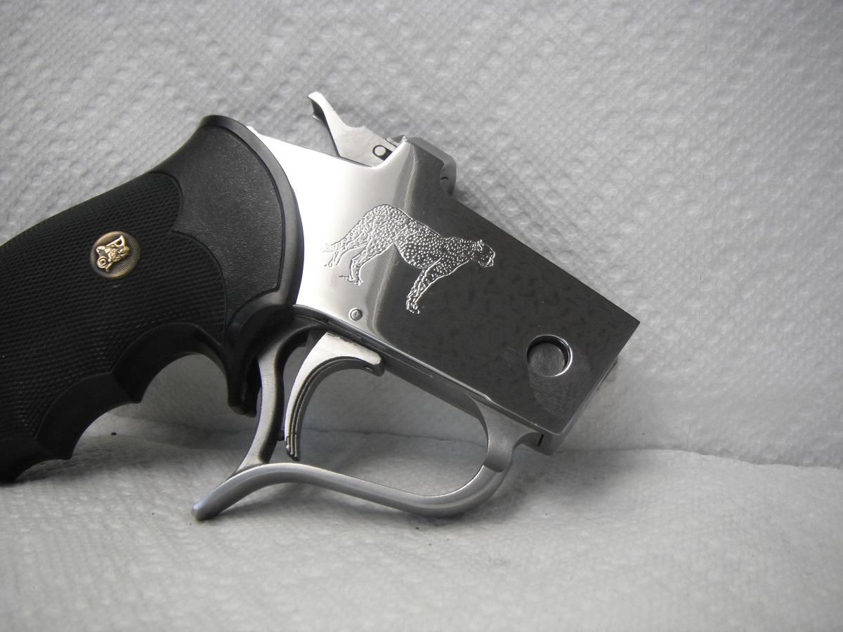

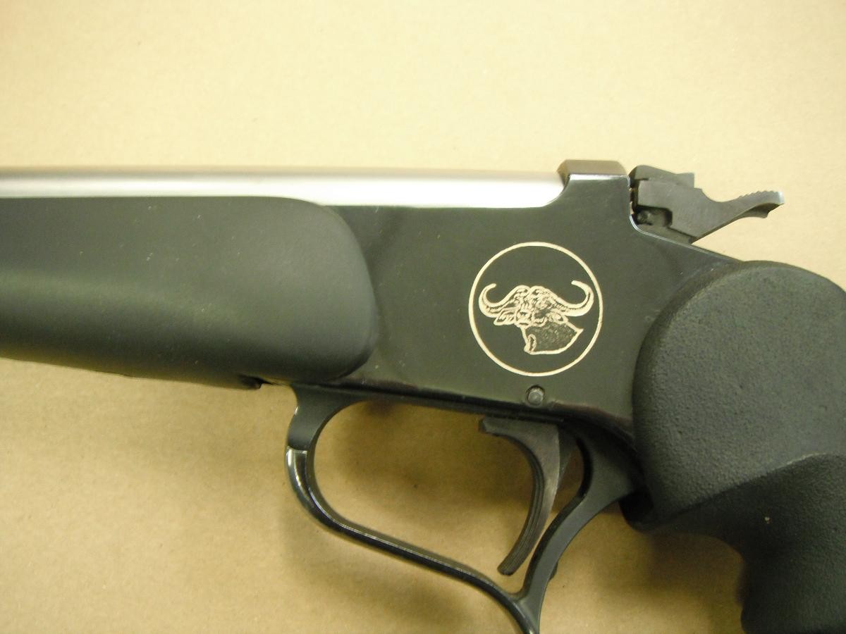

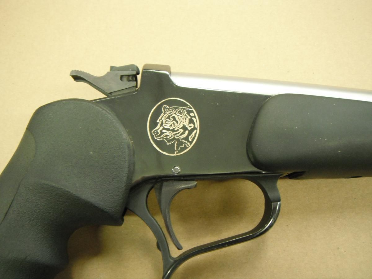

We slab sided most of our TCs and engraved whatever the customer asked for on them.
![[image]](images/uploaded/202004212014065e9f540eac5b4.jpg)
![[image]](images/uploaded/202004212014315e9f5427def2f.jpg)
![[image]](images/uploaded/202004212030155e9f57d77e626.jpg)
![[image]](images/uploaded/202004212030585e9f5802a66c4.jpg)
![[image]](images/uploaded/202004212032375e9f586557ab6.jpg)

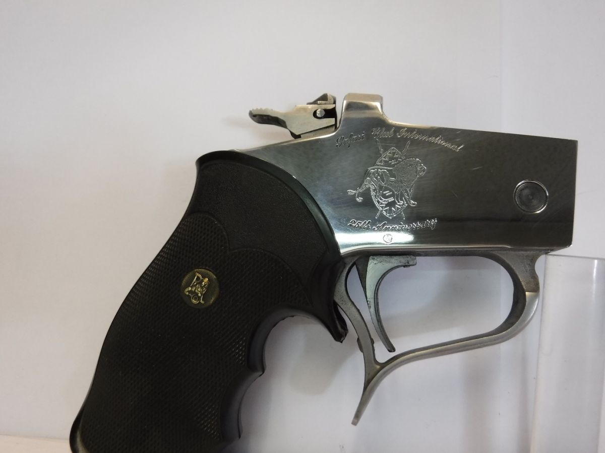

We did special TC packages including several barrels and 2 frames. We did a nickel finish on them back then.
![[image]](images/uploaded/202004212034095e9f58c1e7b74.jpg)

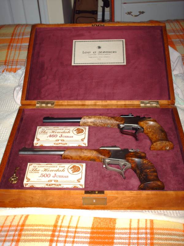

Lee Jurras' original Howdahs
![[image]](images/uploaded/202004212055005e9f5da4bfa26.jpg)
![[image]](images/uploaded/202004212055315e9f5dc3b93e7.jpg)
![[image]](images/uploaded/202004212055545e9f5dda4d7f3.jpg)
Guess I'm just dumb, what is slab siding?
Clyde
Tuesday, April 21, 2020, 17:38 (2394 days ago) @ Gary Reeder
buffing the old TC logo off the sides so they are flat
gary reeder
Tuesday, April 21, 2020, 23:13 (2394 days ago) @ Clyde
Contenders
