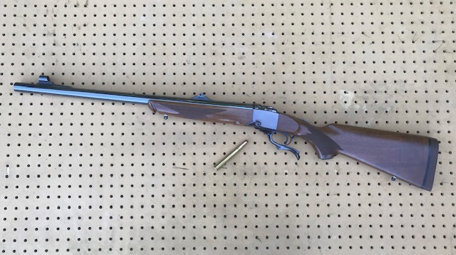

We shot a few different pieces to practice and test. One odd rifle he brought was a unique Ruger #1 Doug bought used as a whole kit with dies and brass, bullets. Old JD did it a while back. We've had several GNR reworked No.1's and it was interesting to see what JD did. This one is basically just rebarreled. I think it may have a mercury recoil reducer as it weighs exactly 10 lb. 2 oz., admittedly the balance is spot on. Word is there were two in this caliber .450 No. 2 Nitro Express 3-1/2", JD still has the other. It's no real improvement over the plain .450 NE except the brass case is shored up and superior as to life and pressure mitigation. It achieves .458 Win. performance at very low comparative pressure due to the huge case. Oh you could boost it in this modern rifle to near .460 Wby. if you wanted, but no need for such excess.
The gun itself is nicely blued with the receiver a slight plumb hue as typical. The barrel looks to be very high quality with a chamber brake and lots of small holes, like I've seen on shotguns. The sights are sturdy steel with a rear island. There are no provision for any optics at all. The nice, away from your hand in recoil, barrel mounted swivel stud is missing and a prominent in the way UM stud was placed on the forend. Must make a note to self before firing, ouch.
The one round we had for testing was loaded with 95 gr. RL15 under a 500 gr. Woodleigh. Recoil was not bad with minimal muzzle rise. (that's Doug's long hair not mine) The weight and brake seem well suited to this platform. Luckily there is an ample supply of Jamison brass as it is a little hard to find. I plan to fix Doug up with some fun hog shooters in the form of 500 gr. RNGC and moderate charges. It will be a unique fun gun.

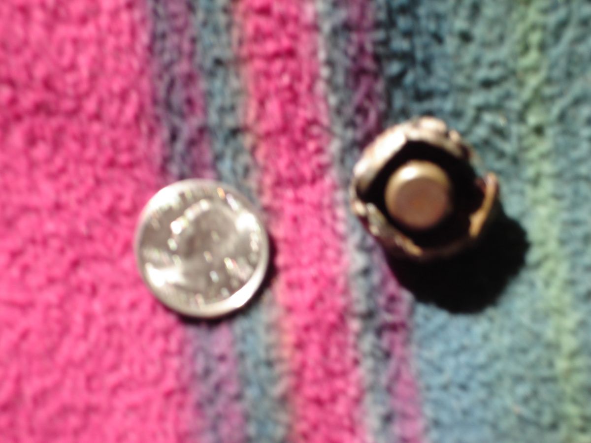

What an interesting trip. Gary built me a 450 Rigby Rimless, which is the 416 Rigby blown out to accept a .458 bullet. While estimates vary, the bison was 1500 to 2000 lbs. It broke the hitch on the truck that transported it back to the skinning shed. This was also the trip where I used a 416 Rigby No. 1 Beast, also from Gary on an unfortunate pig. The shot blew the pig off his feet, pushed him 4 feet through the air where he hit a fence, slid down and ran off! WB has a video of me finishing the job with a 410NBR. The pics are the 416 Rigby Beast and the 450 Rigby at the range getting ready, and the pics from the hunt. Thanks to Woody for turning me on to the 450Rigby Rimless. With a 550g solid, it is among the best Cape Buffalo medicine available. The 480g 450 Rigby Rimless from Kynoch did a fine job on the bison. [image][image][image][image][image][image][image][image][image][image][image][image][image][image][image][image][image][image][image][image][image][image]
