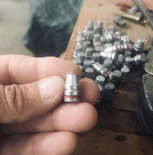

of their head what bullet this is? The maker and mould? I bought a pallet of “scrap lead” from a friend and it turned out to be bullets in 3# steel coffee cans! I’m only having to lube/size them. I really like this one for .38/357, it works in 9mm too but the body is a bit long for the internal case taper. You can’t generally seat it in the 9 all the way as you’d typically like. But close, and it runs a well in about anything.
This batch is getting sized 0.358” and running about 132-133 grs. For fun I noted adding lube to the raw bullets adds 0.3 grs.
![[image]](images/uploaded/202006241510395ef36cef78bf6.jpg)
Running the old 450 greaser. Anyone know off the top
