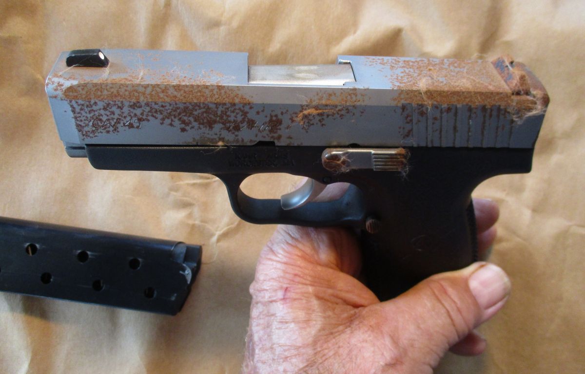

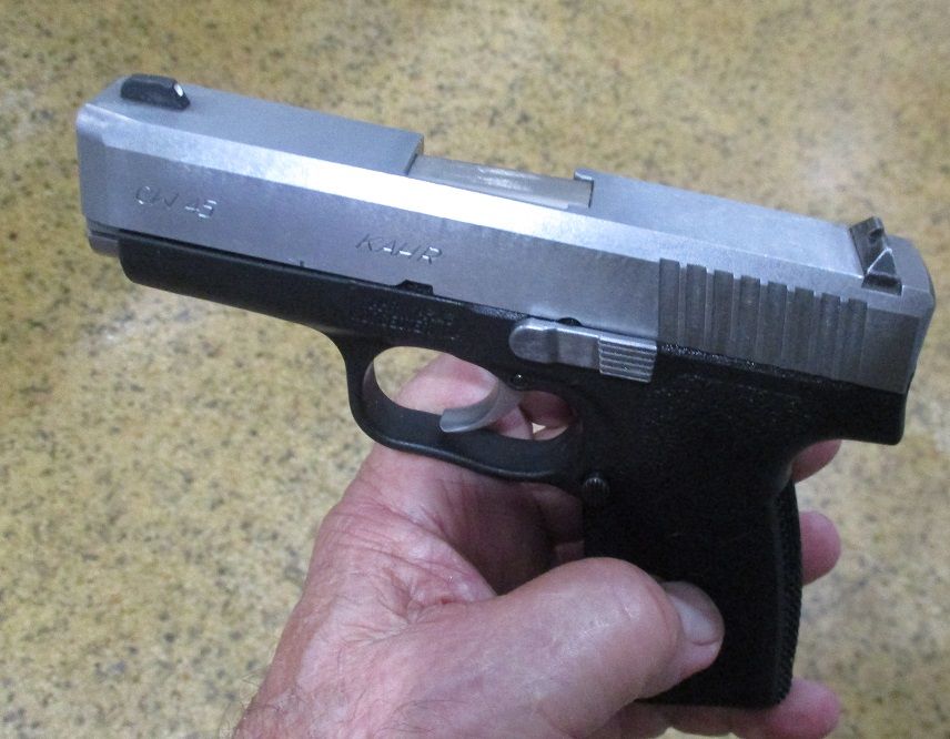

don't like the cheapness of the way they are made ... lots of things I don't care for about them ... BUT .. I picked up a Kahr CW 45 the other week for about nothing. The person selling it needed money .. it's a long story. Anyway .. the gun sat in a safe for several years, in some kind of gun storage bag .. was never cleaned .. and rusted to the bag.
This is what it looked like when I picked it up.
I killed the rust with penetrating oil and bronze wool.
![[image]](images/uploaded/202007070207395f03d8eb34669.jpg)

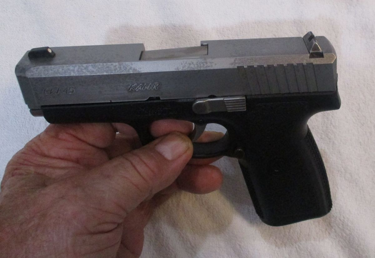

Been polishing on it in the evenings. It's coming along.
![[image]](images/uploaded/202007070208195f03d9132ebe1.jpg)
The thing functions just fine. Only problem I ran into was it would not chamber .452" bullets. I mic'd the barrel and the bore is .450" ...
So I sized some of my cast bullets down to .450" and will load them soon and see how it does.
Shooting offhand at 15 yards it was easy to keep all the shots together.
It is a no frills gun ... long smooth trigger pull ..feels like you cock the striker all the way. But all I have into it is a little cash and some sweat.
My first plastic pistol.
Coming along pretty good!

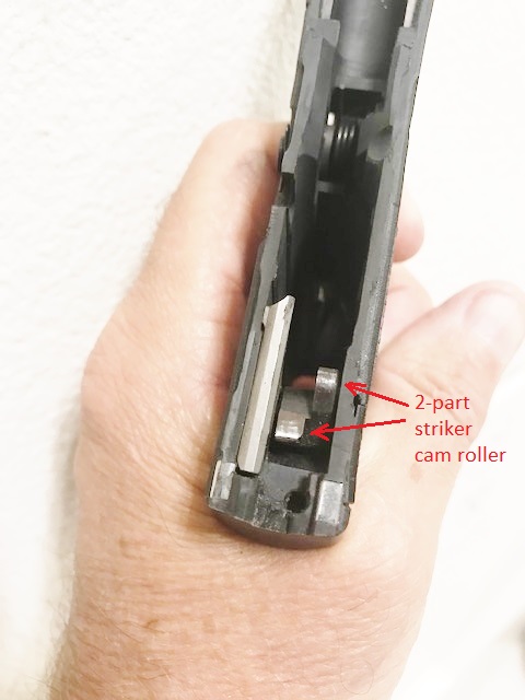

Just as a design study this is the
Monday, July 06, 2020, 21:16 (2318 days ago) @ Derek
mechanism that the internal frame trigger bar rotates counter-clockwise as the trigger is pulled to move or cock the striker in a long two stage manner. However it is designed to never stack or have a gap, perfectly staged to give a striker cock and drop in a deceiving smooth feeling long single stage, that is really two. A relay of sorts.
The South Koreans are a pretty smart bunch. I hear their cars are doing really good as well. As I said I'm not a diehard Kahr nut but I do admire the innovative design and engineering.

That long smooth pull is due to the cam action of the striker pull, as one travel lever loses mechanical leverage another takes over to finish the pull. It feels like one smooth pull, but it is actually two stages. I find them quite accurate. I own a P380, PM9, and P40. My P40 is the same size as a Colt M1903 .32 Auto but has 3X the power and is several ounces lighter at 16 oz., it's amazing. I'm not a dyed in the wool fan, they were a deal, light and small. I can hit with them. The one to watch out for is the PM40. I personally think it is simply too much power for the small package. They originally had mags coming apart in recoil but I think they may have that sorted. You can often find them about 1/3 of retail as they kick like the devil. Usually Kahr have horrible resale value, better just to keep them around for a rainy day.
