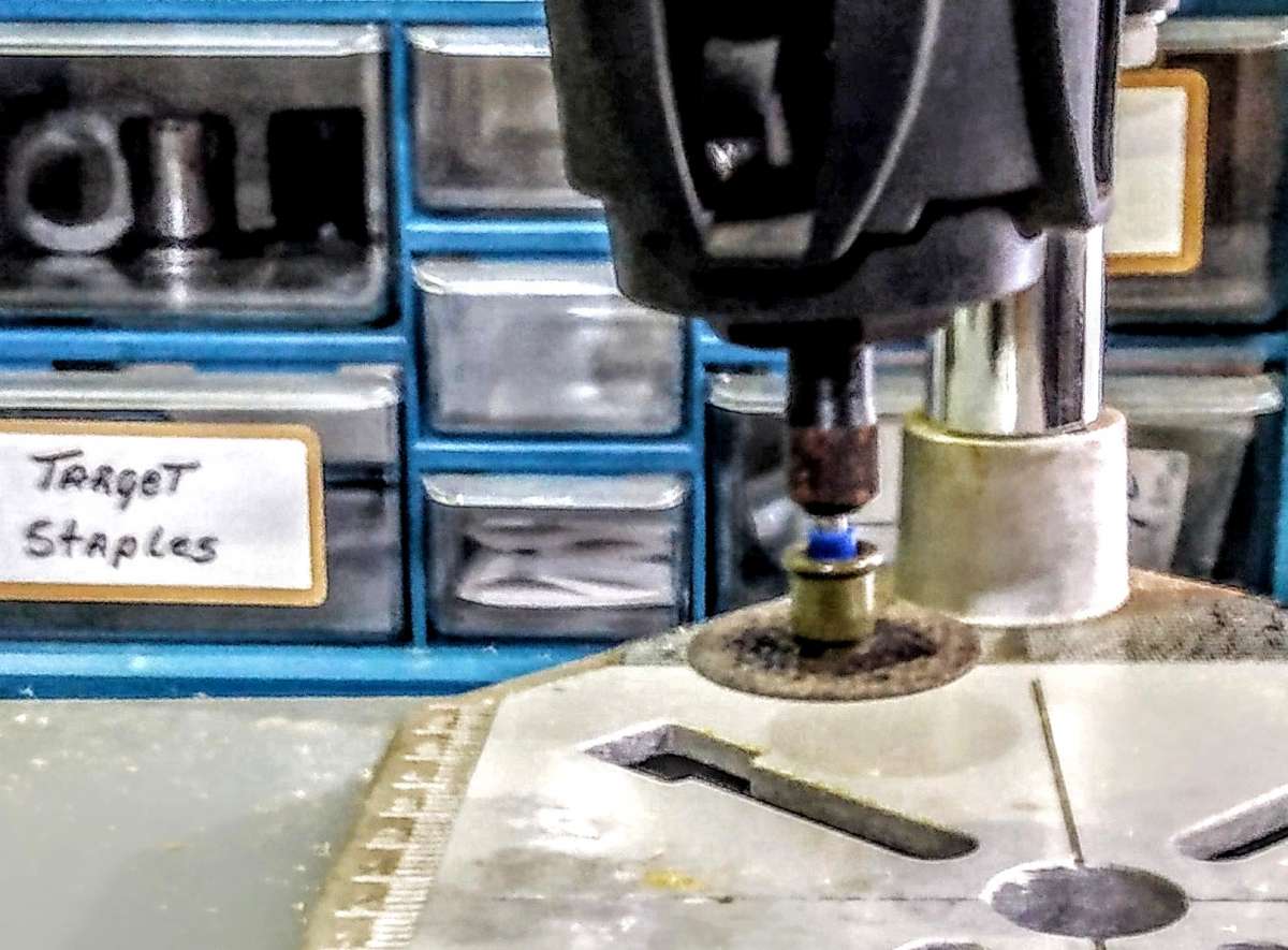

I use a Dremel Drill Press. It's the fastest way I've found to trim cases with a factory smooth cut.
Set the cutting blade above the base plate just a tad higher/longer than you want the case. Sit the case on the plate and rotate 360° with two fingers.
I use this for 300 GNR, 500X1.4", 458 D-MAX, etc.
Not the best pictures, but everyone will get the idea. Just trim to final length, chamfer and load.
![[image]](images/uploaded/202007130046405f0baef049f30.jpg)
Trimming cases for Wildcats. Everybody's got a way...

hard to tell. Looks like you are reaming out a
- gary reeder, 2020-07-12, 18:34
- saw the same thing as Gary - Sunny, 2020-07-12, 18:57
That's the quick change adapter
- WB, 2020-07-12, 18:57
