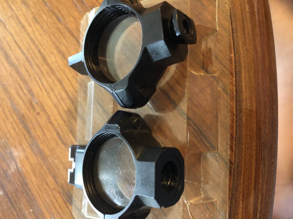

Oh Man, I scored a set of the Millett scope rings with the open sights on top. But, the rear ring doesn't have the nipple for the Leopold dual dovetail mount. The front ring does. The rear ring looks like it has grooves on the bottom and a hole for mounting directly onto a scope base? It didn't have any mounting screws. What guidance can you give me? Thanks!

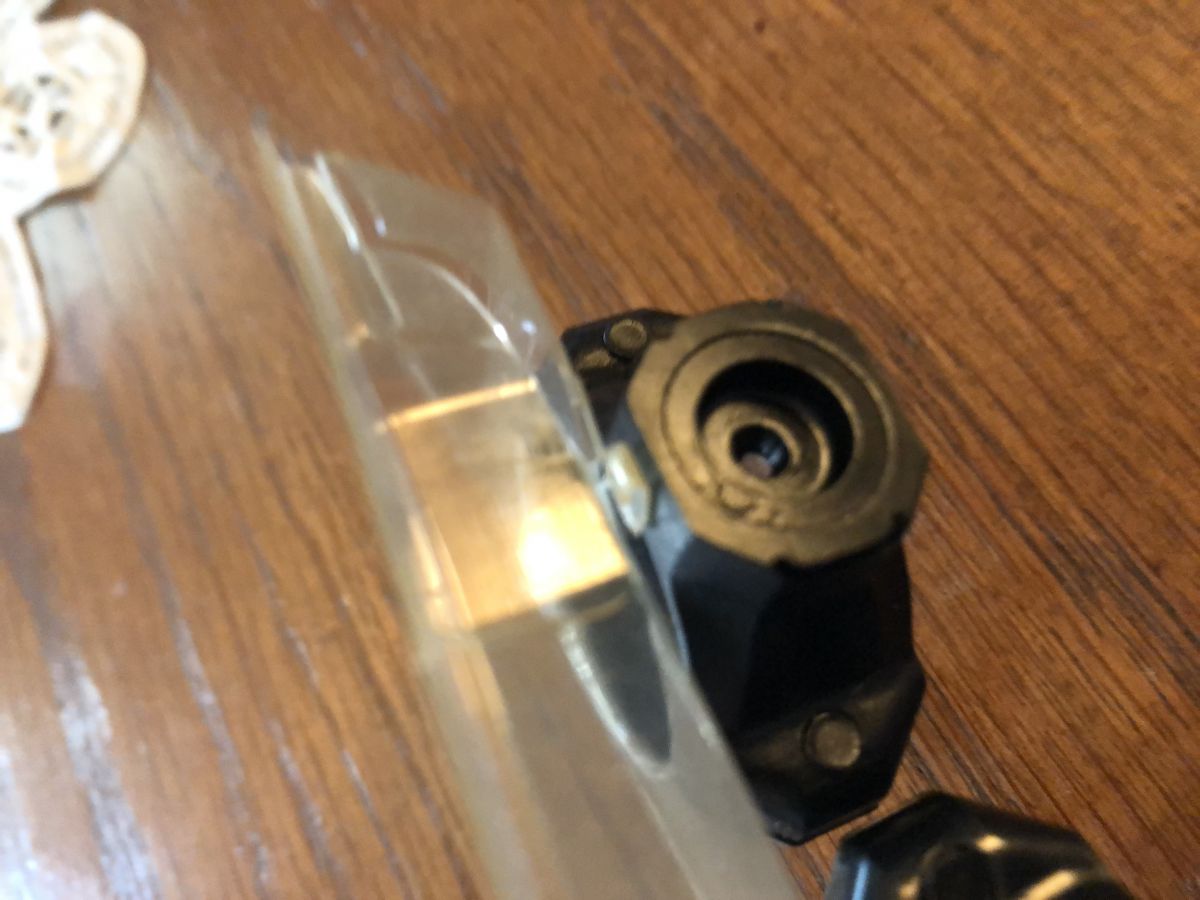

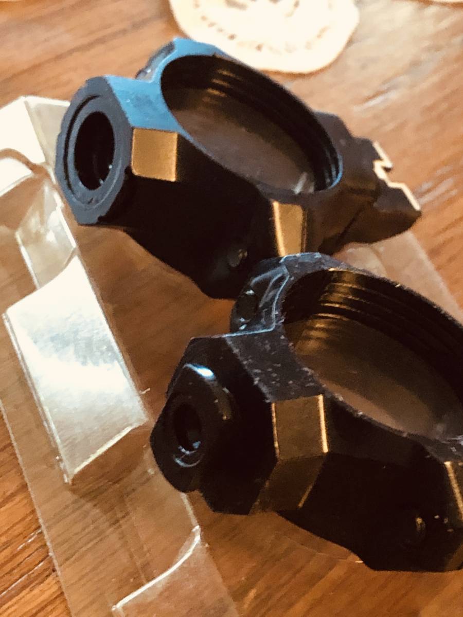

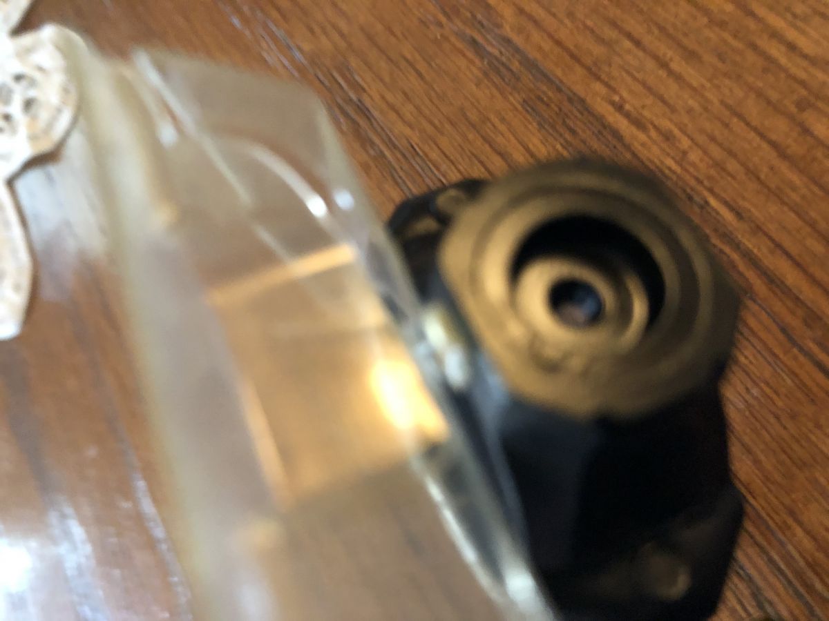

Wow! Thx! The package shows Med
GregG
Monday, July 13, 2020, 14:15 (2311 days ago) @ WB
pics - see how the bottoms are different? Strange. Did I get ripped off on Ebay?
atatched[image][image][image][image]
