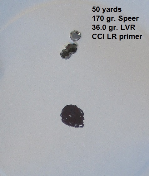

I put 120 or so through it this morning. Testing functioning .. seeing what would come loose.. and firing some groups.
Best group of the day
![[image]](images/uploaded/202007241841165f1b2b4c69cbc.jpg)
Loads with 3031 and H322 shot lower so I will leave the scope set where it is for now. H322 hit POA.
Have a few issues to deal with but it is showing promise!

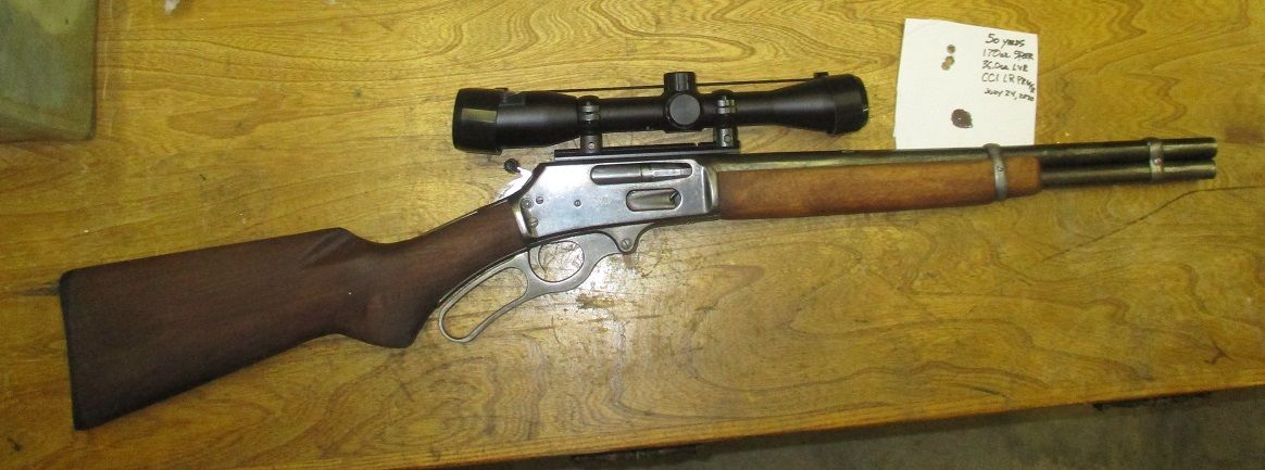

![[image]](images/uploaded/202007241843225f1b2bcacb228.jpg)

I got one for my bday in 1979. I've never found a bad one. Was glad to see the 444 Marlin brought back too. Introduce the same year as I was.
Great shooting and those home projects are just plain fun.

I like the bob-job and how you trimmed
Friday, July 24, 2020, 20:21 (2300 days ago) @ Jim Taylor
the forestock. Very nice subtle touches. I am inspired by your sow's ear projects of late. I have an old Glenfield 60 that has been neglected too long. Also a Remington 550 that was taken apart and never fixed. A long forgotten .270 bolt gun too. Lots of projects on the cheap for fun.
Some cast FNGC would be interesting with some Unique or other pistol powder. The 150 or 170 gr. at 1500 fps will leave a mark and penetrate like the devil.
I like the thinner stock and forend.

The standard Marlin stock and forend of today feel fat to me.
I have some 168 gr. HPGC loads with Unique. I will get them a try after I get all the bugs worked out. No big issues with the gun. Worst problem is the ejection. It's what I call a "Limp Dick" ejection. The empty cases roll out onto my shooting hand and fall to ground by my feet. Makes it easy to find the brass but sometimes you wonder if they are gonna make it out of the gun.
I have some fixes for it but it's working and I would rather work up some loads for it... at least for now.
The “ejector” as they call it is that bobby-pin
Saturday, July 25, 2020, 12:32 (2299 days ago) @ Jim Taylor
Held in the back of the frame (with that peg and hole in the frame) and slides along in that groove in the back of the bolt. Pull the bolt and it usually falls out. It’s a real crappy design, in my opinion, they have been using for around 130 yrs. But what do I know?
Brownells sells an aftermarket better one. Of course you might try to just bend it out some and see if that helps. The spring may have just taken set. It’s worth a shot. It might even have the tip broke off. Need to check it.
The rifle is actually new and if fired, not much.
Saturday, July 25, 2020, 13:13 (2299 days ago) @ WB
The ejector seems to be "short"..It won't throw the shell out.
there are several fixes ... I will keep tinkering till it's the way I want it.

Looks really good. I’d like to see a front sight on it, but that’s just me.
If I go to an aperture sight it will have one!
