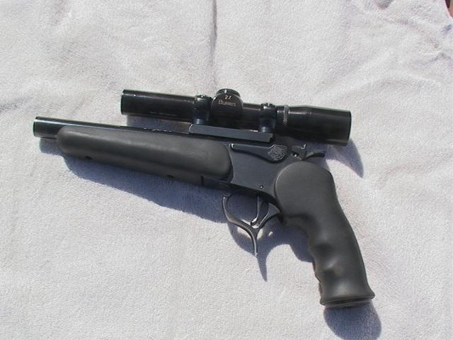

my main "go to" pistol has been the 9" 41 GNR
Saturday, September 12, 2020, 12:51 (2250 days ago) @ WB
for many years. I built it in 1979. It has taken more animals than I can count.It was originally on the Contender frame but recently I switched it to my new G-2 frame.

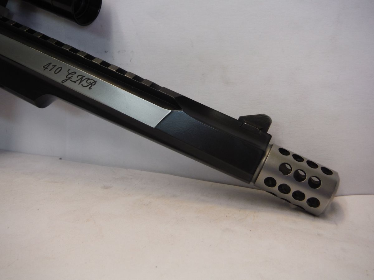

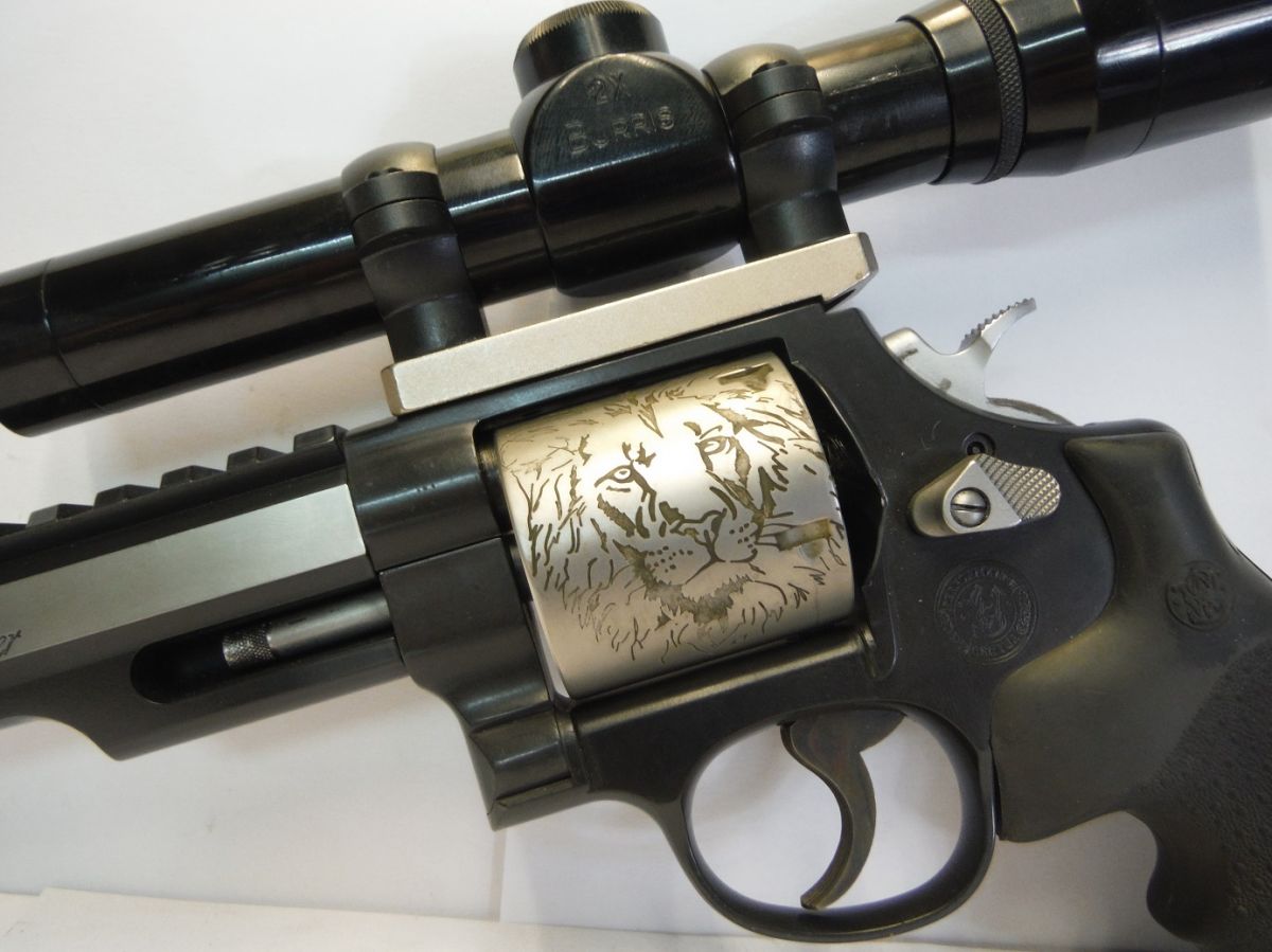

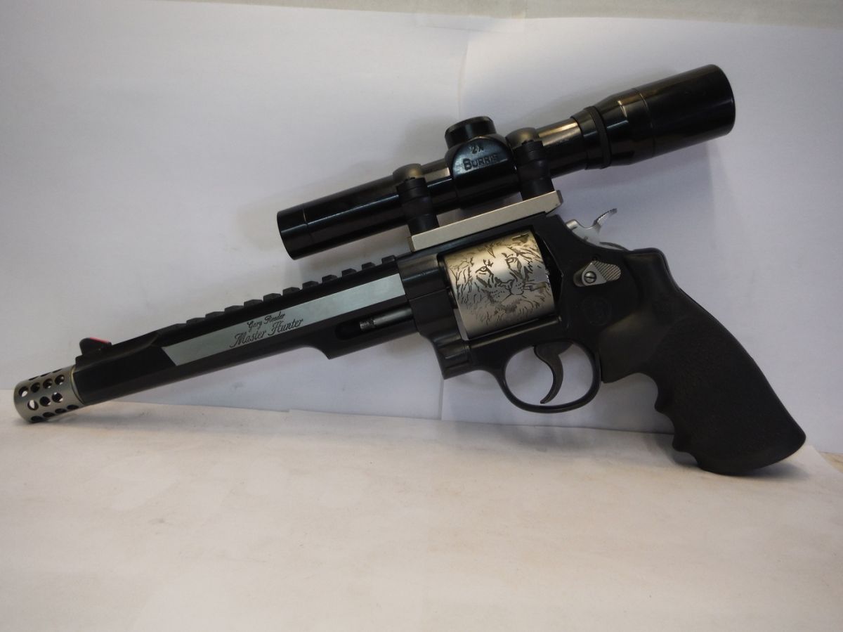

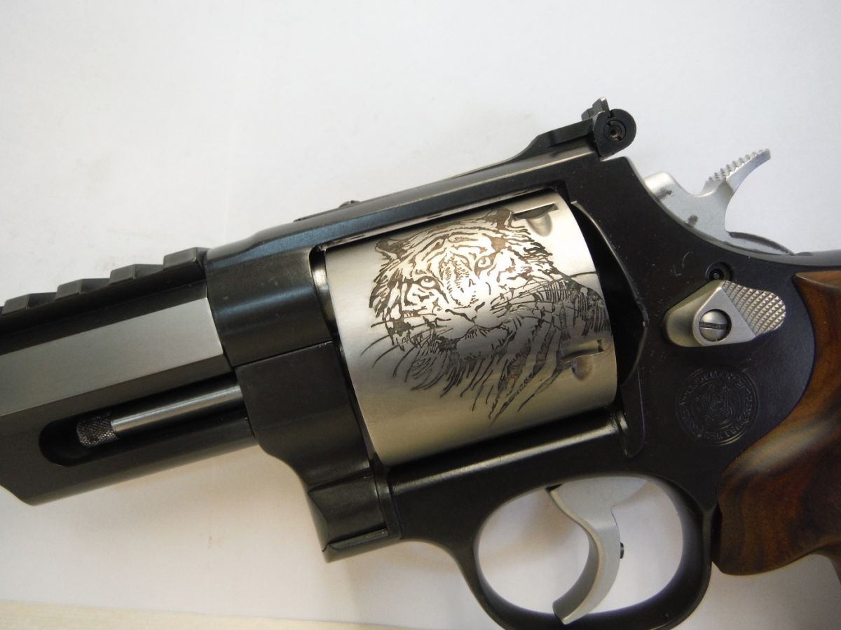

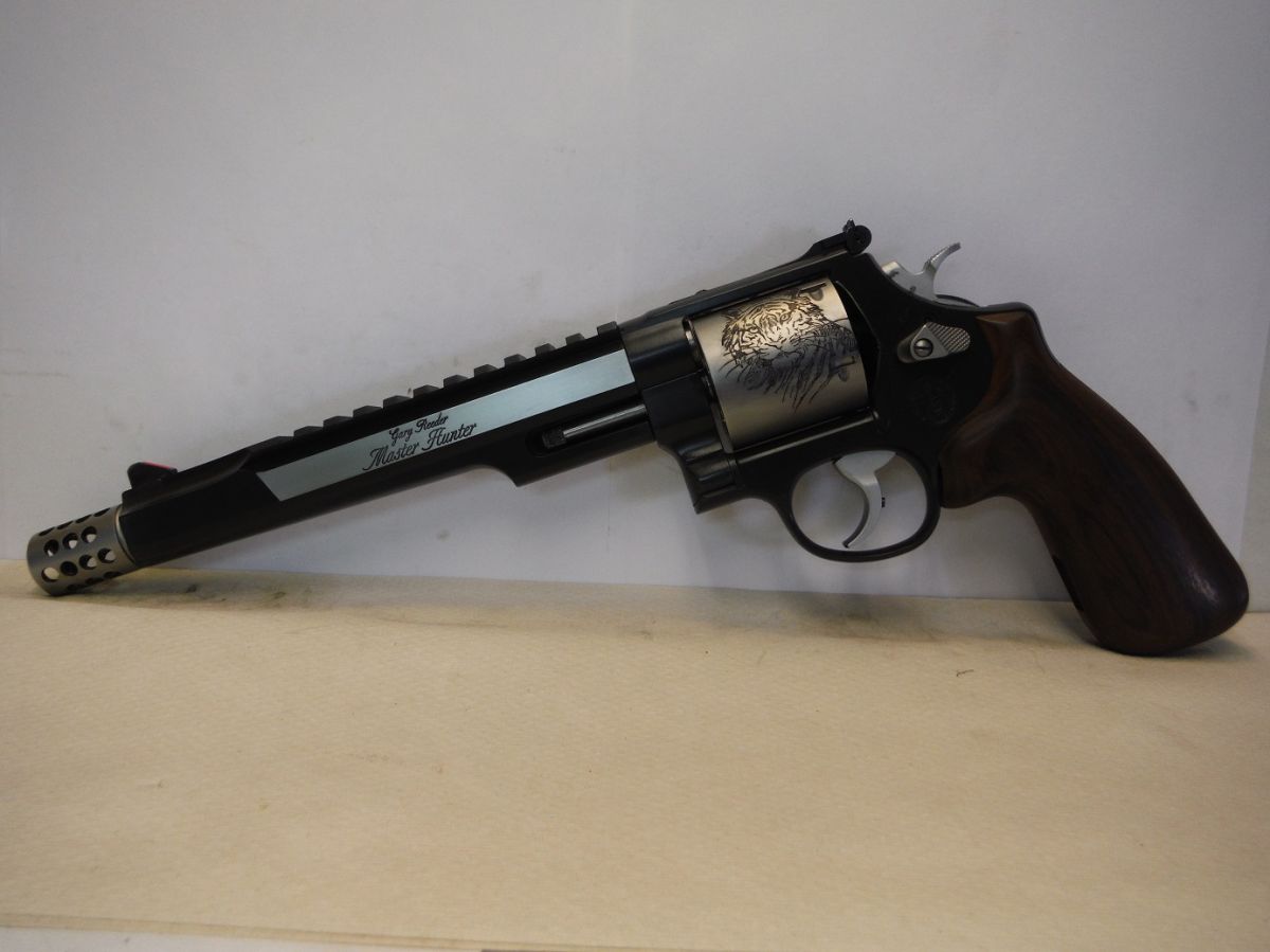

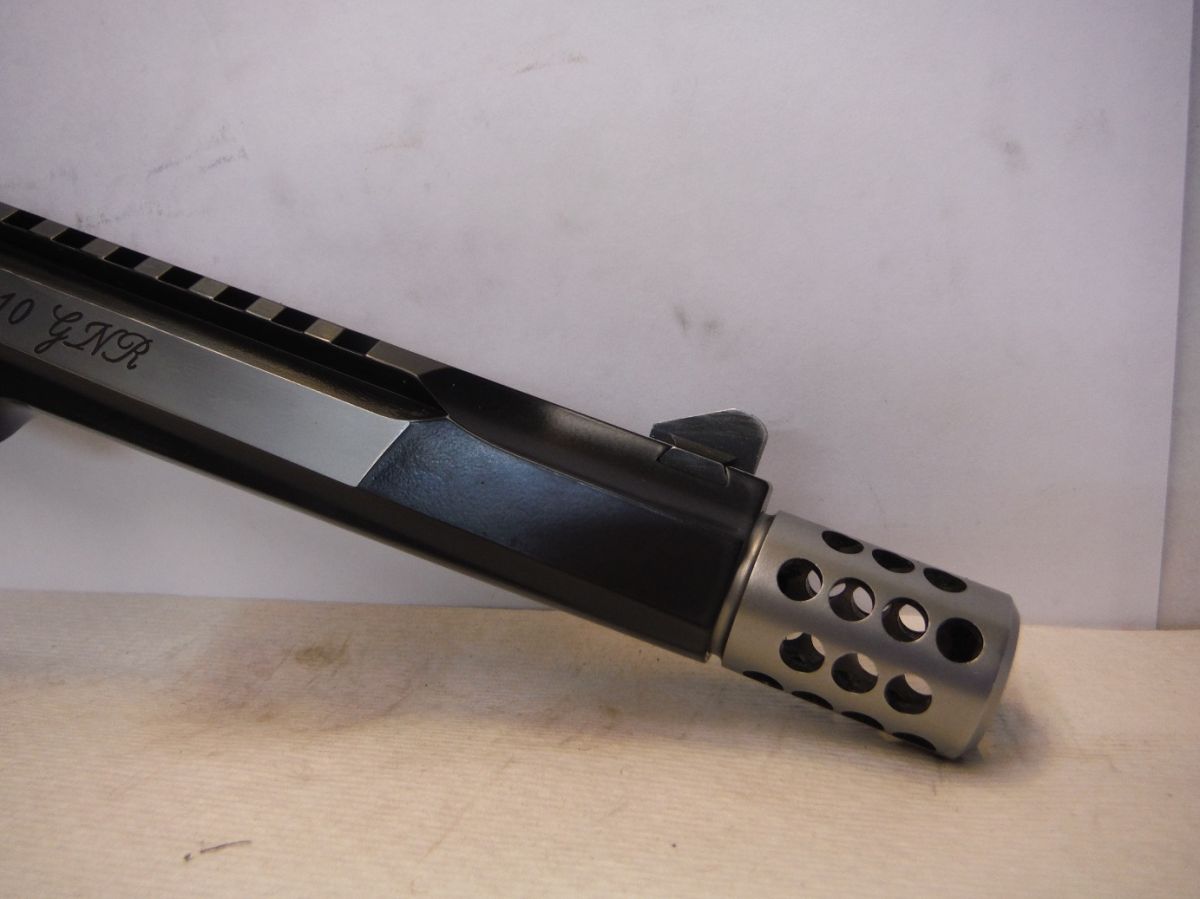

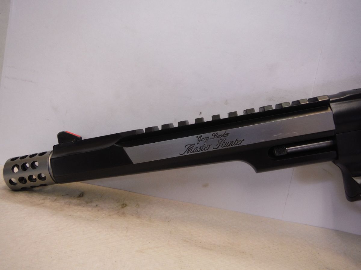

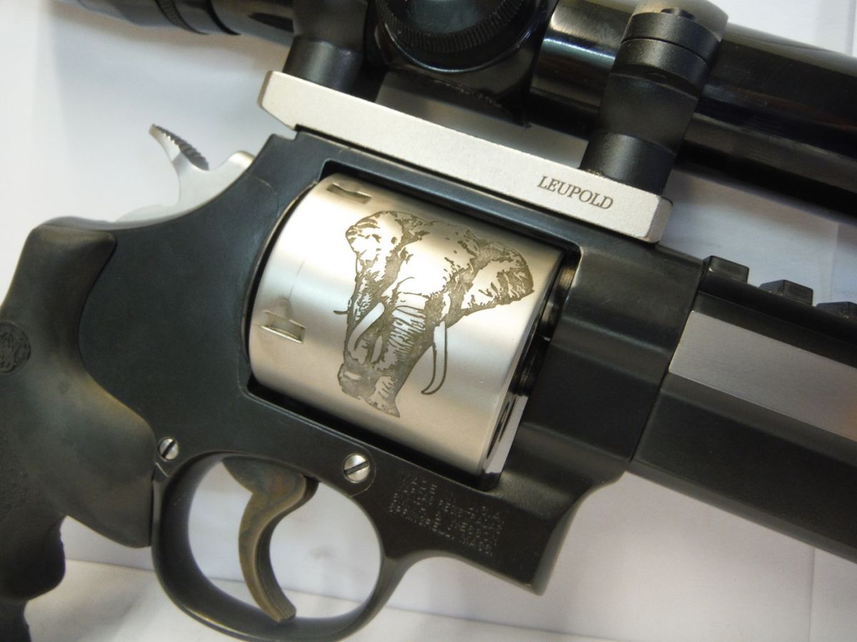

But another of my favorites is my one of a kind Master Hunter based on the S&W model 629, fully customized. It is chambered in 410 GNR and is one of my most accurate revolvers. It has the Dan Wesson type barrel and shroud with the brake in front acting as the shroud nut holding the barrel to a .002 gap. We built a new 41 caliber barrel and 5 shot cylinder in 410 GNR for the conversion.

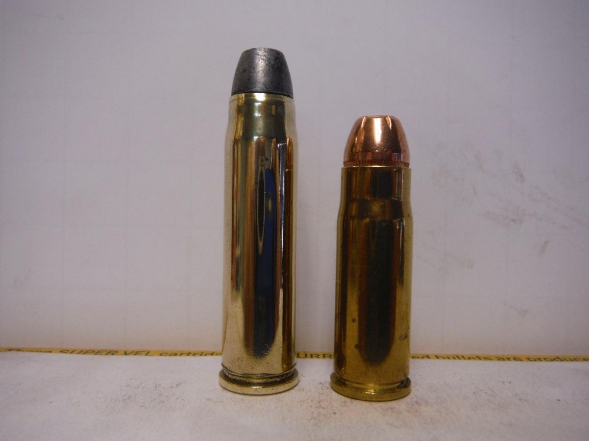

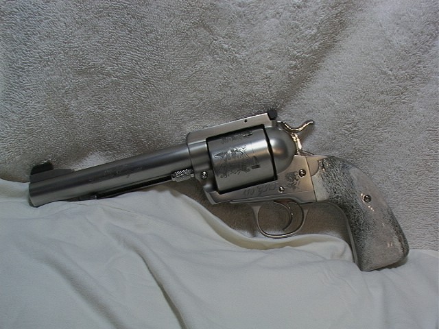

I have yet to take anything with my 411 GNR, but maybe this coming HHC. In the pic, 411 GNR on the left, 410 GNR on the right.
