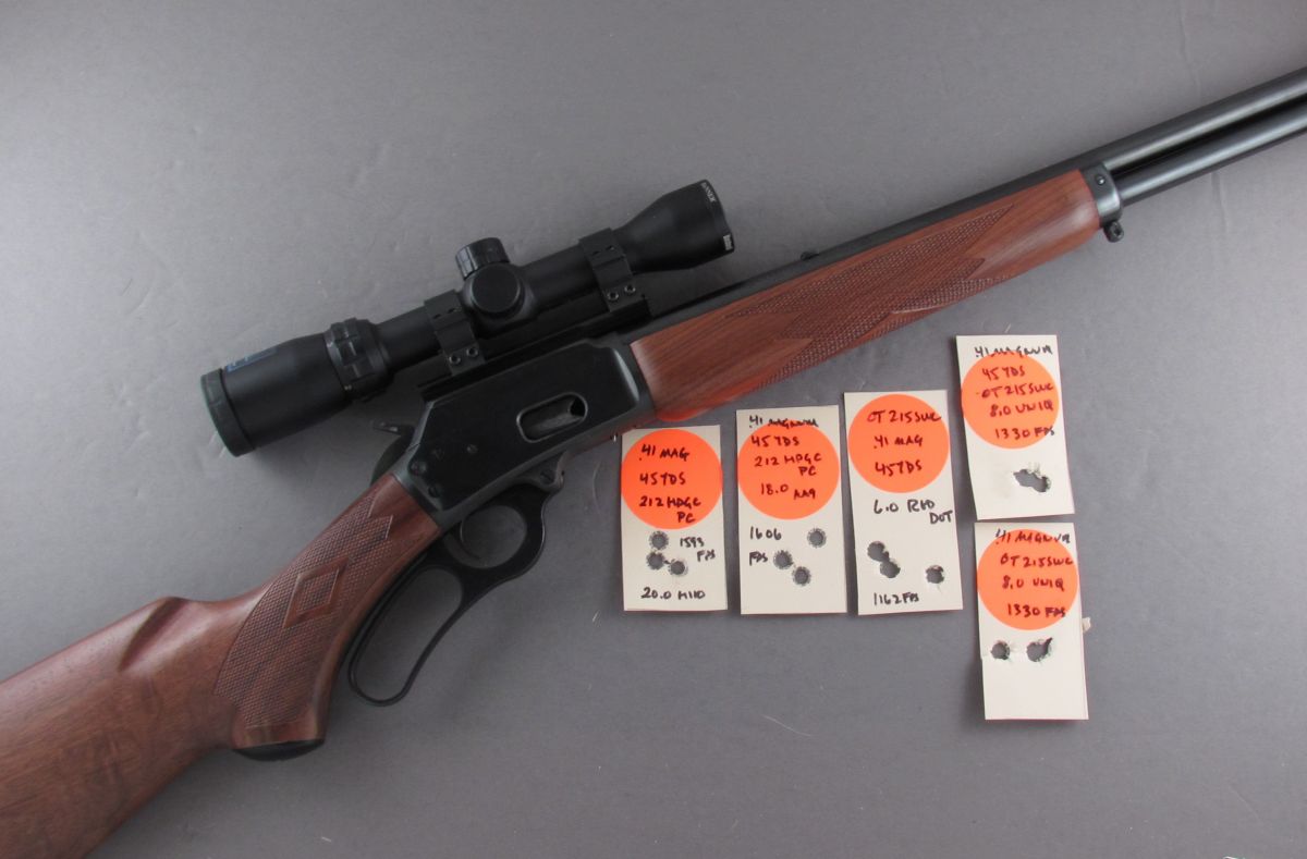

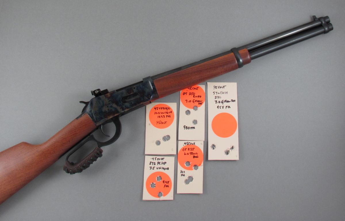

THEY WORK! SEE BOTTOM LEFT IN EACH PHOTO
Saturday, September 26, 2020, 10:09 (2236 days ago) @ WB
STAY AWAY FROM BLACK HARBOR FREIGHT--EATS BARRELS
