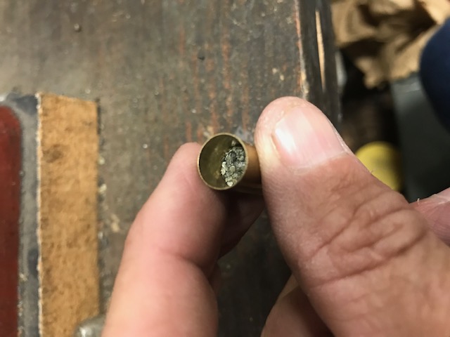

3.0 hrs. HP38 is not much. A great powder that I also use for .32 ACP

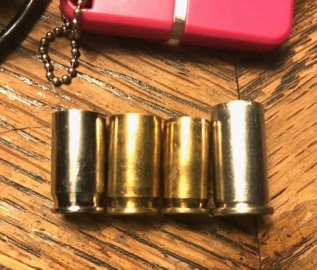

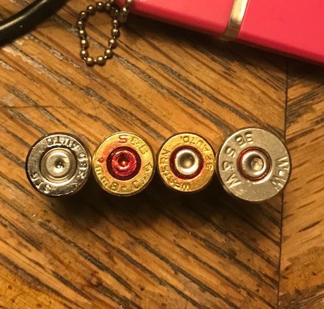

I had some 9mm Browning Corto cases that are the same as .380 ACP except for the extractor groove in the case design. But the still fit the shell holder.
Far right; .380 ACP, 9mm Corto, .32 ACP, .38 S&W

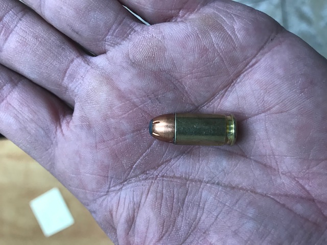

At HHC I was gifted some .380 brass to play with and some 100 gr. JSP.
