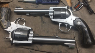

MTM
Saturday, October 10, 2020, 15:06 (2222 days ago) @ Huey
It was a 40/10mm, reamed the 40 out to 38-40, and made it a Bisley. [image]
I did the exact same thing...
Huey
Saturday, October 10, 2020, 15:33 (2222 days ago) @ MTM
Either it's the most accurate Blackhawk I own or I just shoot it best. Either way it's awesome.
