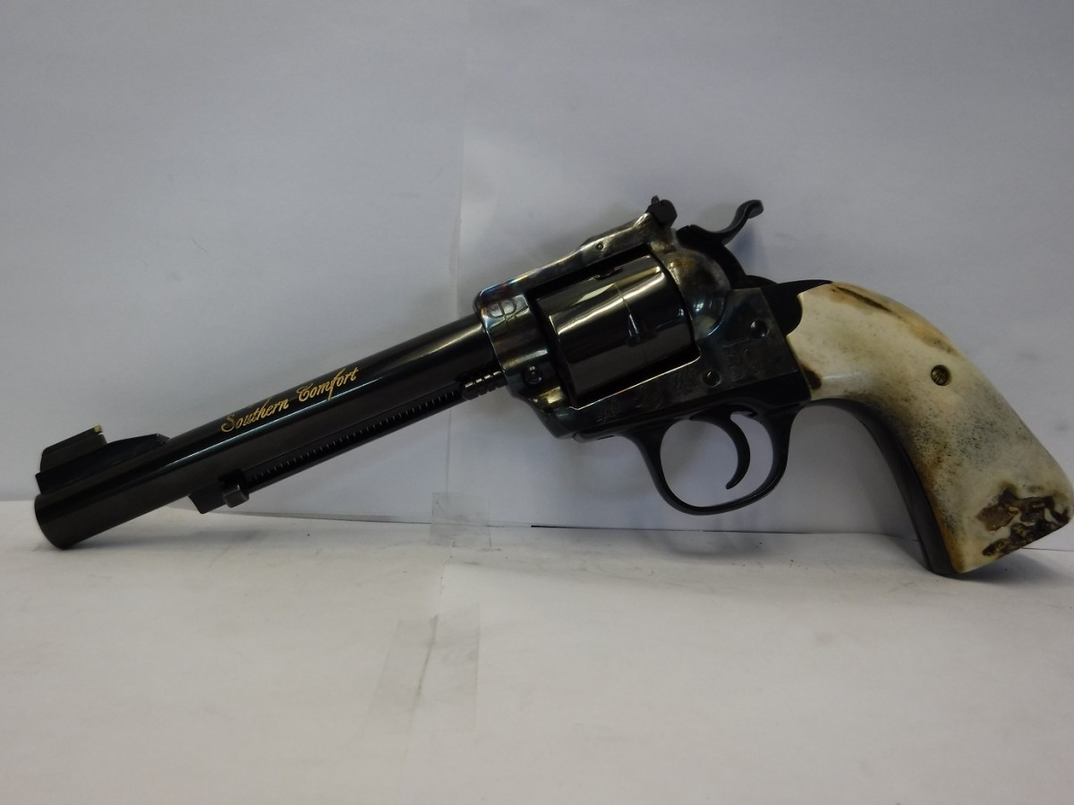

Not wanting to beat up my fine little custom I loaded some .40 cases (long seat - 10mm spec.) with some Berry's 155 gr. HP and 180 gr. JHP to give an initial test. I used the same 8.5 gr. Longshot charge. The 155 ran 1337 fps average in the 6.5" Trailgun and my 180 gr. averaged 1267 fps. That will do nicely!
![[image]](images/uploaded/202010131454305f85bfa62c230.jpg)
Trail Gun 10mm/40
