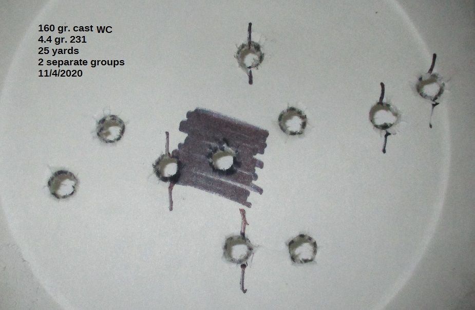

The 160 gr. wadcutters that leaded so badly last time shot clean. I took the advice and tumbled them in Lee Liquid Alox. But I cannot get the accuracy from them that I get from the round-nose flat-point 160 gr. bullet.
![[image]](images/uploaded/202011041940195fa303a391f6b.jpg)
There are 2 5-shot groups on this target. The first group is marked. This was typical 25 yard accuracy.

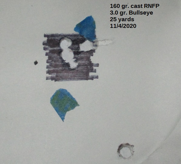

![[image]](images/uploaded/202011041941175fa303dda2dac.jpg)
The above 2 groups are about average of what I was doing with the RNFP cast bullet. My old eyes seem not to be able to see the sights for very long. A couple good shots and then things start fuzzing ...

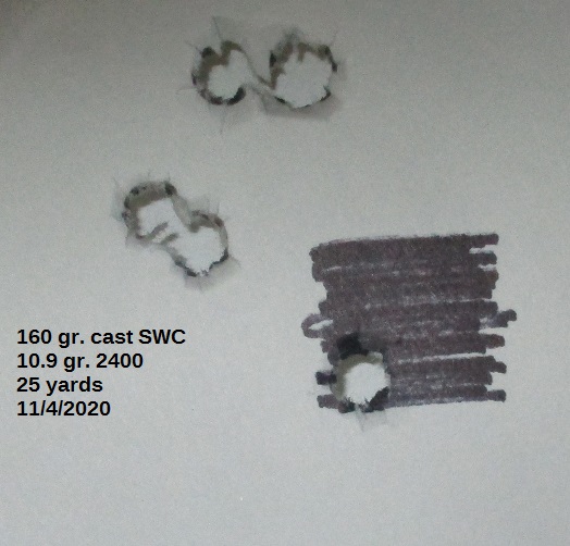

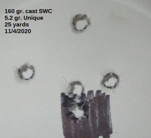

160 gr. cast SWC loaded with heavy 2400 load and one with Unique.

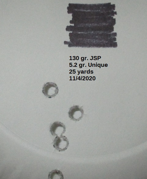

130 gr. JSP. It shoots OK. Haven't found a tack-driver load for it yet. I am gonna try it in the .357 Magnum.
The Model 10 will shoot IF I can see the sights and IF I can hold it still during letoff. Over all it seems to prefer the round-nose flat-point 160 gr. bullet.
