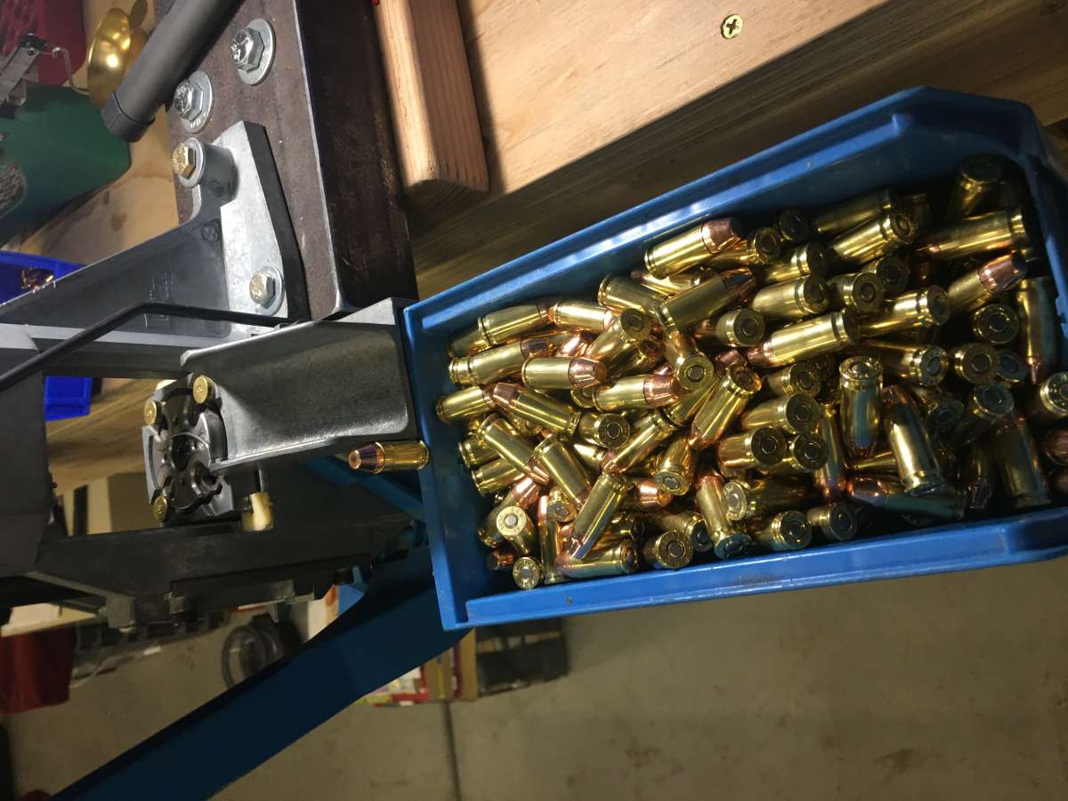

Weather was windy and snow today so got some reloading accomplished.
9mm 125gr FP. Got to thinking about how much this pile is worth according to internet prices.....A lot!

What bullet are you loading in those photos

I have been trying to find some 125g FP, I have been using 122g cast
Look like plated

Xtreme Bullets

I’ve used both the 9mm and the .45 225 gr FP. Both are good.
Brent, have you checked the OAL of that cartridge with those
Monday, November 09, 2020, 12:47 (2192 days ago) @ Brent Clark
bullets? I have used maybe a hundred of them that someone either sent me or they were in an estate we bought out and for them to be at my set OAL of 1.15 I had to seat them right at .010 from where the taper starts. I noticed that yours are probably .065 or .070 from where the taper starts. Not saying your loading is wrong but in my guns that would be too long to go in the magazine. The company may have changed the design of the bullet and made the nose a bit shorter in the years since I tried them. If they fit in your magazine, just disregard this post.

Must be different. I mistyped weight, they are 124 gr not 125, but that’s nothing.

very good. Sorry for the hassle but I have loaded a bunch
Monday, November 09, 2020, 16:38 (2191 days ago) @ Brent Clark
in the past and then had to go back and seat the bullet just a tiny bit deeper so they would fit in the magazine. My fuggup.
