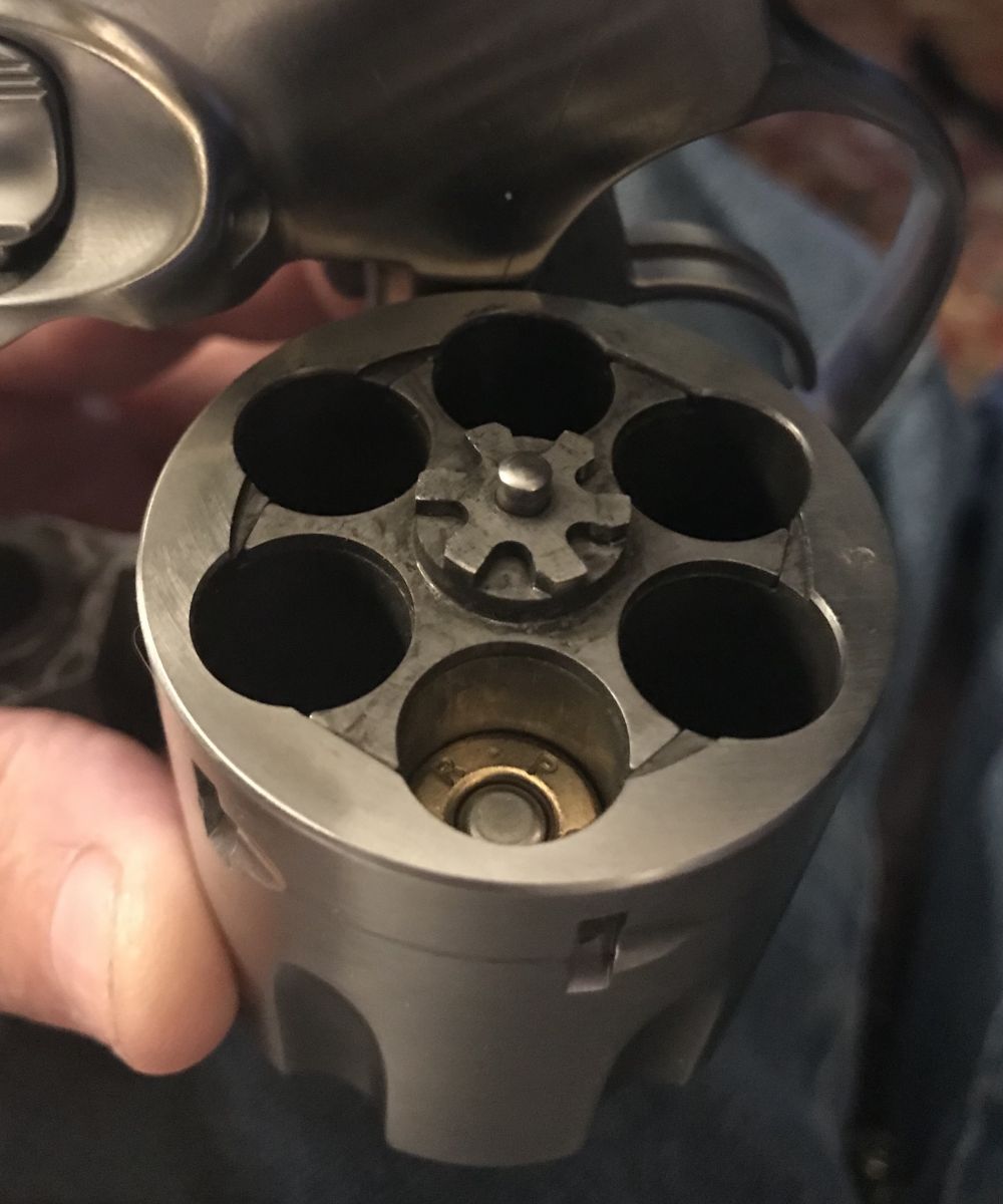

Yes, at least in mine. Just don't 'hot rod' the WinMags.

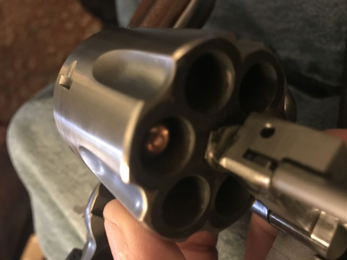

It appears to have been done
Ronnie P
Tuesday, December 15, 2020, 11:28 (2155 days ago) @ Blake
