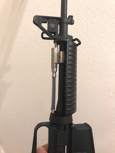

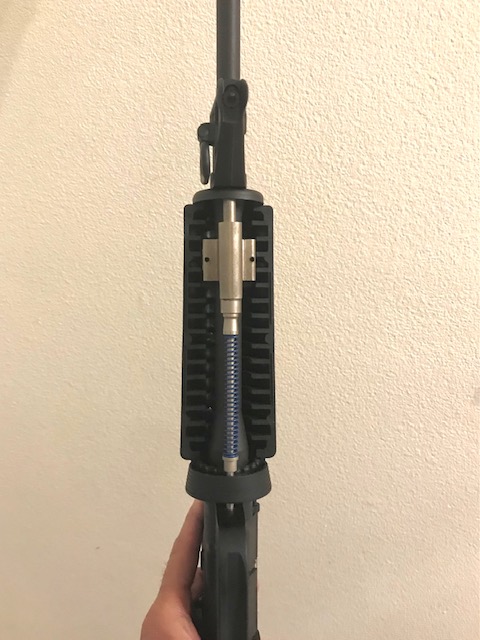

a little fun today. I inherited an AR15 16" carbine from a friend. It has this modified "gas piston" conversion done on it. I examined it closely. They first torque the barrel nut to align the "gas tube" hole in the upper and barrel nut sprocket to a very high amount. This is for the piston rod to pass through as it pushes on a blanked off bolt/gas key on the bolt assy. It looks like a blow back 9mm part but has the locking bolt head.
The front half uses only about 2" of a gas tube and mates with a new gas block attachment, collars, captive spring, and gas piston rod. It looks simple enough. I noted the special reinforced hand guards included with the kit that would seemingly afford some protection if it all went North! It didn't look fired, ever. I found only minimal information on the net about the TN bunch that USED to market it as a kit. Sort of makes it like an AK or SKS in operation.
