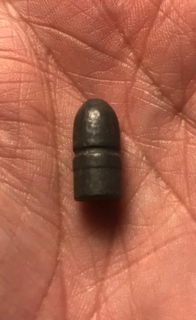

Bear Creek Cast bullets in CA. They are my .323 (8mm) heeled 120 gr. RN. For the .310 Martini (rechambered for the .32-20 case) you typically shorten the case about 1/10" and press fit the bullets. This way the bullet does not get in the throat with the OAL. They are normally pushed to 1200 fps +/-. These are dry lubed and mic 0.322" and step to 0.313" at the heel. Actual .310 brass is very rare and has a very thin rim, you can lathe cut .327 Fed. I'm told. The .32 Winchester hulls make life easier.
They have bullet moulds. I'd want one with a flat point. But (500) store bought will last a long time in a single-shot.
I'll scan his product sheet and post it. The guy was real nice and called me to confirm the order.
![[image]](images/uploaded/202012191958245fde5b6078a1a.jpg)
