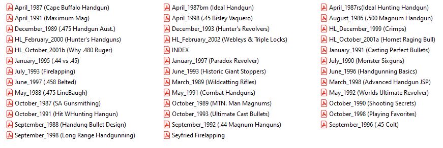

Tuesday, December 22, 2020, 08:06 (2149 days ago)
I think Sean gave me the old article collection I was searching for so long ago. For a while back in the 1980's-90's I truly savored the G&A articles. They were gold. No real mainstream internet back then so the monthly articles had real validity. I can't believe that was 25 years ago. They were the only available resource for such advanced topics and refreshed every 30 days! Seyfried seems very opinionated but that is OK, aren't we all to a degree. I really appreciated his spirit of searching and experimenting. He hunted with Elmer Keith as a boy so that may have been an influence. Keith was opinionated too so I see a pattern.

We'll use some of these for future converstions
