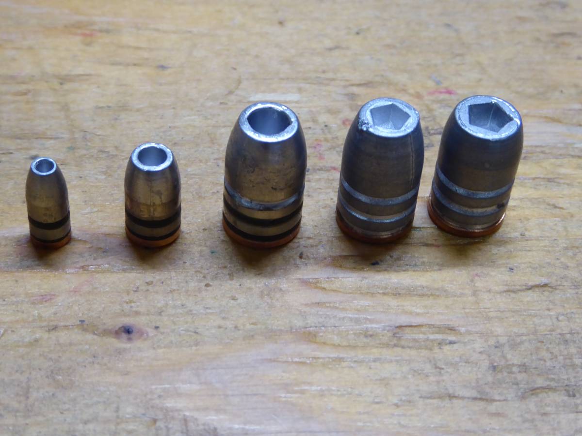

Depending on the intended use
Mark Conner
Friday, December 25, 2020, 11:42 (2145 days ago) @ Drdougrx
of the bullet, the alloy, velocity, depth of HP and a couple others, I think there is every benefit and no minuses to a HP. A few of mine... 22 cal.50 grs., 30 cal. 100 grs., the next three are 45 cal. 280 grs. and both the penta points 295 grs.
![[image]](images/uploaded/202012251840505fe6323293879.jpg)
i have used in my Henry .41 as a cup point and my 6" dan
