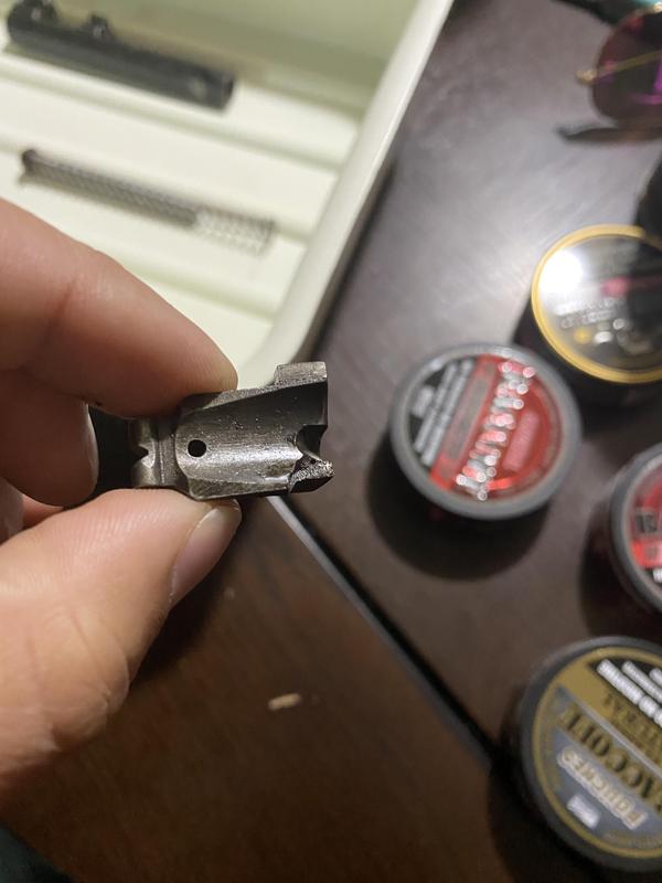

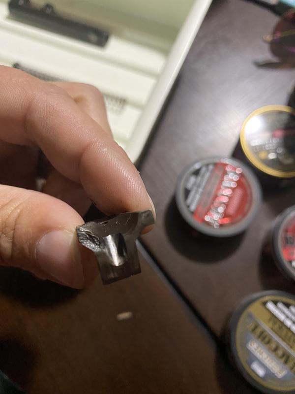

That button on the side is the release. I have has the Helwan Egypt made single stack clones too. I broke an ear off a locking block on one shooting this hot STEN machine gun ammo back in the 1980’s. Man it was like a .;8 Super! Nice thin gun and accurate shooter! Very Euro savvy.
Not to discourage but it’s interesting that
Sunday, December 27, 2020, 11:55 (2143 days ago) @ WB
In the “readers gallery” section another fellow had the exact same issue I had on my old Egypt contract gun. Some of the old surplus machine gun 9mm is HOT! I bet a 124 gr. At 1200-1300 fps! From that platform. It shoots a ball of fire, stings the hand, and will break the gun.
![[image]](images/uploaded/202012271854445fe8d8742f222.jpg)
![[image]](images/uploaded/202012271855215fe8d899357b1.jpg)
