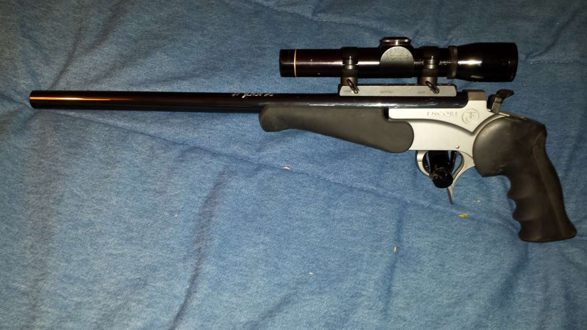

i have a set on my 41gnr#2 encore
carl hackney
Monday, December 28, 2020, 13:17 (2142 days ago) @ WB
[image]16 1/4 tapered barrel i've put around 50+ rounds of 210 xtps and 20 or 265g cast. haven't had any problems .i put them on as i thought i was going to switch between pistol and carbine. but it shoots so well as a handgun i doubt i'll ever switch.
