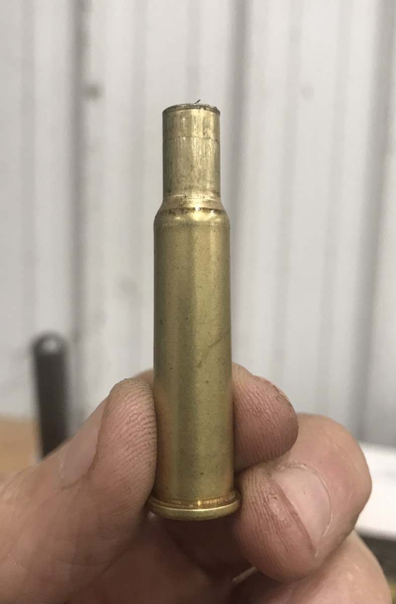

You can see the case bulge after necking as far as I dare.

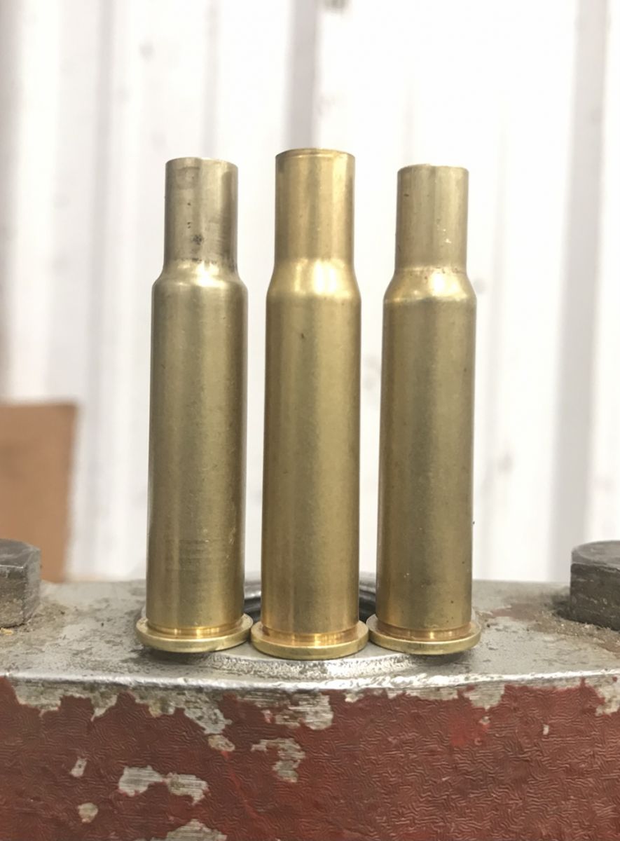

This is the fire formed case far left, a raw fired .30-30, and my form case. The changes are very subtle but highly important. I found some dies for about $100 but I'd sure rather spend that on re-chambering. I'm not a big fan of the 7mm International. I've sourced some 7mm Merrill dies that I might be able to use. It is the .225 Winchester necked up to 7mm.
