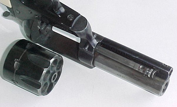

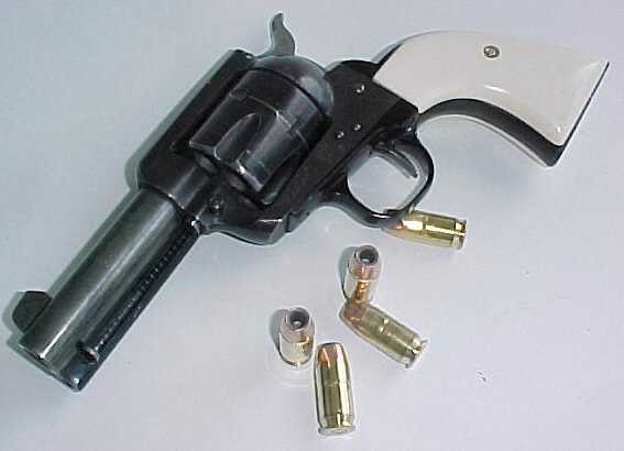

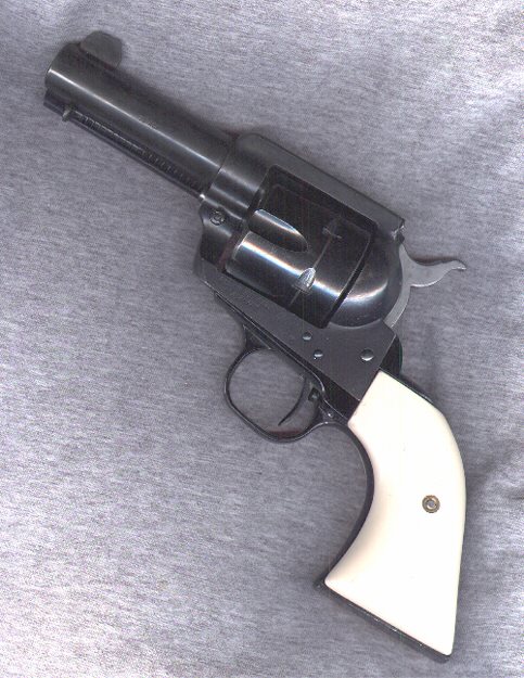

Some years ago I had a "Packing Pistol" built. It was a fun little gun and I enjoyed it. When I moved to Africa it was sold to help finance the trip. I have forgotten where it went but I hope whoever got it enjoys it.

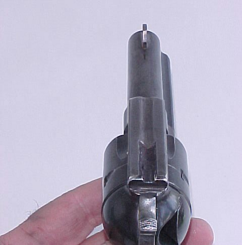

I started with an Old Model Ruger .357 Blackhawk. (Not a flattop .. I flattopped it with my horseshoe rasp)
I had it rechambered and rebarreled to .45 ACP with the barrel as short as practical.
Note that I left the old sight in. Later on I had the top strap welded up and re-cut to Colt SAA configuration and then I had the gun nickle-plated.

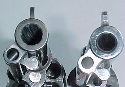

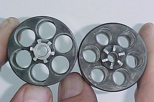

ACP cylinder compared to .357 cylinder
ACP and .357 comparison
