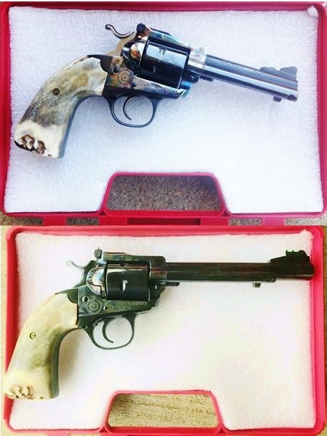

I have a .40/10mm 5-shot on a Ruger .22 chassis. I think that platform is more robust than the I-frame Colts.
Top was it's first rework but stock .32 H&R chambering, the bottom is my specification modification to .400 cal.
Definitely one of the new ones
