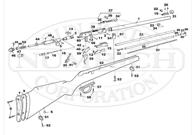

I meant to say I’m going to glass bed it
Sunday, January 03, 2021, 17:35 (2136 days ago) @ WB
There is only one stock bolt on a round pillar. I think I can shim the front and bed in front and behind the one point. Then tightening that bolt will bed the action and float the front with the tube.
That’s the plan anyway.

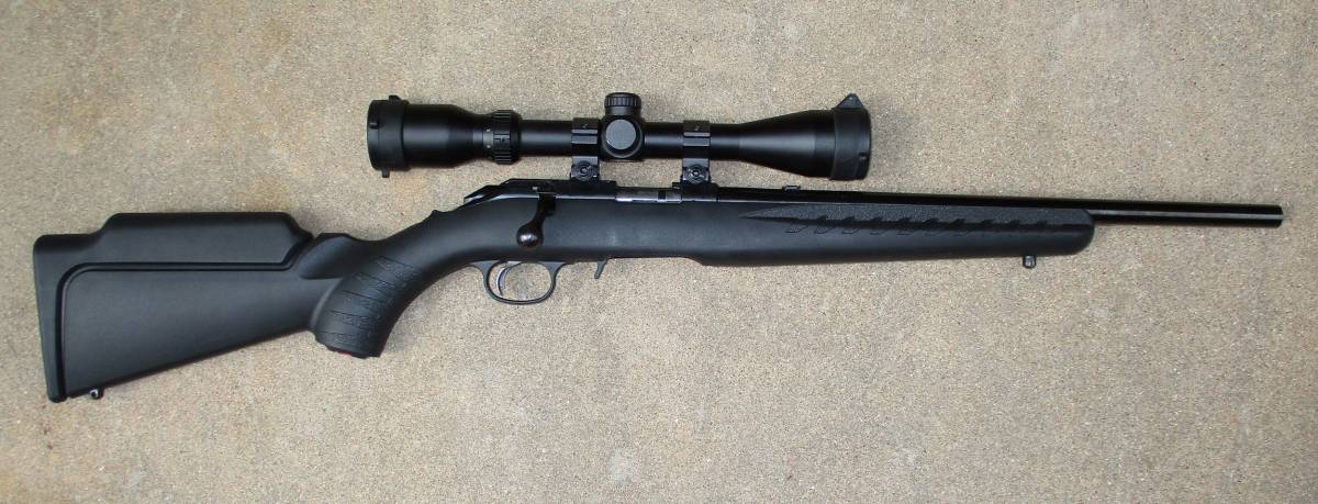

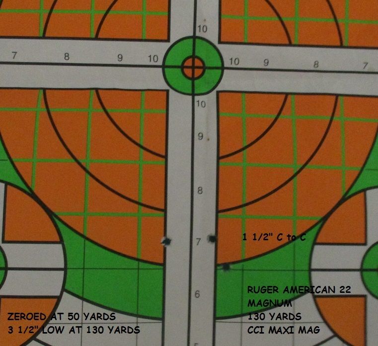

I like the .22 Magnum! The Ruger American .22 Mag
Sunday, January 03, 2021, 18:06 (2136 days ago) @ WB
will shoot one ragged hole IF the shooter wouldn't shake so much!
At 130 yards

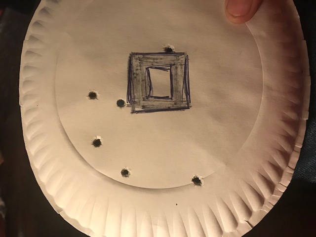

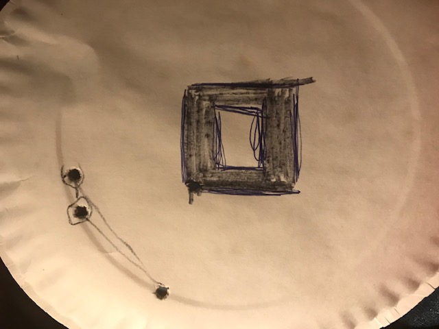

Typical first (3) at 100 yds., heating up same distance.

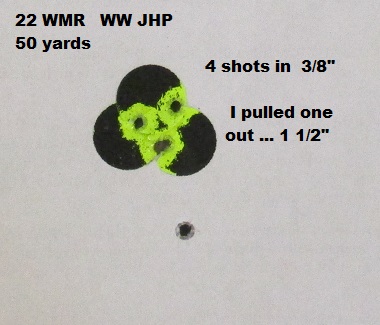

I have Marlins that are 1/2” at 50 with open sights.

That is the problem with the tube feed Mariln
Monday, January 04, 2021, 14:50 (2135 days ago) @ Sid R
It is basically teeter-totter in the stock with that one mid-point stock bolt. I need to fabricate a bed that forces it to "totter" only one direction. Not only am I floating the barrel but the magazine feeding tube under it as well. I don't think the receiver will be stressed. It's mostly a solid tube of steel with that bedding pillar at the front of it.
