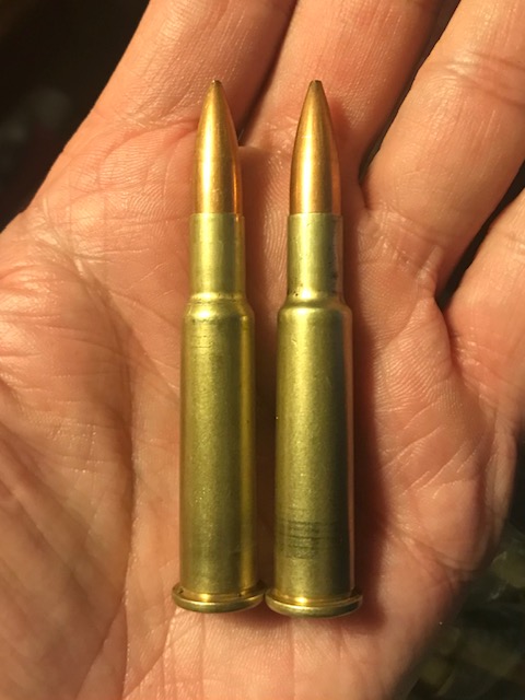

This is a formed 7mm IR case that will chamber, I'll shoot it and form the shoulder and taper to the fireformed ctg. on the right.
