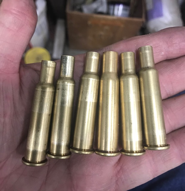

The 7mm Int.R was a tough one to form not having a special die.

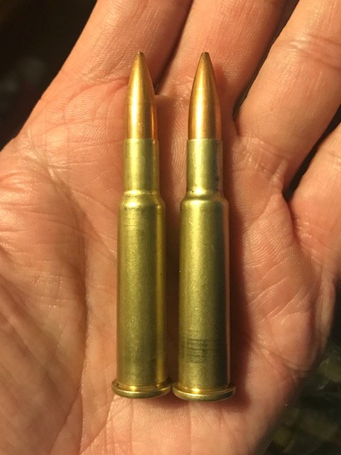

(my previous efforts formed/fit and fired/reloaded)

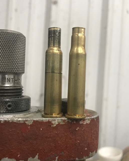

Even as it is you adjust it until you just push the shoulder enough to chamber. A bit of trial and error. I found I had to body size with a 7mm GNR sizer first that just started a neck. I usually load these very slightly necked .30-30 to fire form 7 GNR. The round on left is run through the form die to the point of chambering.
I then trim all to a uniform length. And later wipe clean.
